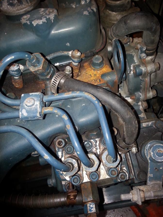

It looks like something has been repaired on the return side as you can see from the pics. There is a non OEM piece of fuel line on the return back to the pump. Who know what has happened in the past. Maybe just a leak.

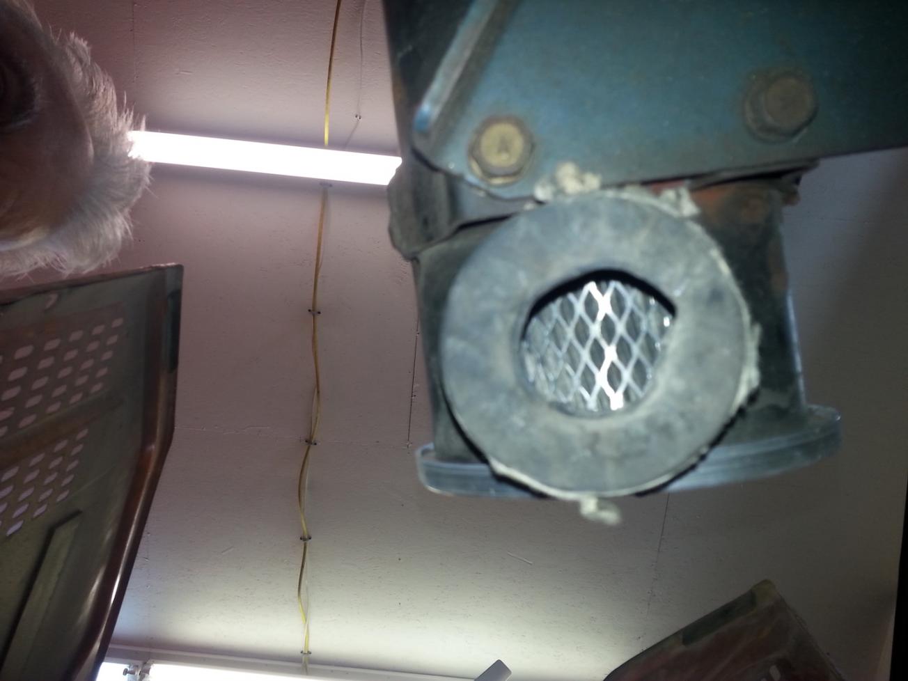

Also the schematic shows theres a valve on the bottom of the air filter housing but in the last pic i don't see a valve, just the filter inside. Anyone know if there is supposed to be a valve on the bottom of the air filter housing and its purpose ?

The return system is easy to diagnose. Just disconnect it at the fuel tank. Stick the hose in a bucket. And if you have an electric fuel pump. Just turn the key on :) if it's a manual fuel pump, just start the tractor and check the jug. If it's filling with fuel, your good to go :D

That "valve" you're talking about on the bottom of the air cleaner is just a short rubber tube/snout that looks like a rubber tube with one end pinched closed. The pinched end is really open but it takes a little weight (i.e. some water or debris build up) to open the pinch and fall out.
