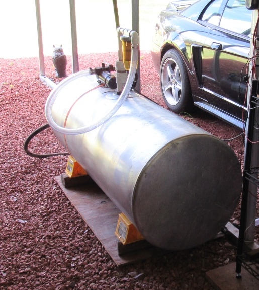

I started with 55 gallon steel drums under a shed. I vented the 3/4 NPT holes with air filters. As the fuel levels were used down they would get condensation in them and started to form surface rust.
I switched to 55 gallon plastic drums in my barn and one of those split. Fortunately the split occurred above the fuel level.
After that I acquired a 100 gallon aluminum Freigthliner fuel tank I keep in my open front barn (3 sides enclosed). It has a vented cap. I added a Goldenrod water block fuel filter to it. I use a cheap 12V transfer pump and added a auto shutoff nozzle.
I power my pump from a 12V deep cycle battery connected to a 100W solar panel and charge controller. I also run a jumper cable off of that and alternate it between my backhoe and another deep cycle battery for a trolling motor using SAE connnectors.
My diesel generator holds about 9 gallons so it's good for at least 12 hours run time. I just carry 5 gallon cans from the storage tank to the generator in a wagon and use a D cell pump to transfer fuel to it as needed.

What type of hoses did you use from the tank to the pump?
Tank to pump is clear reinforced vinyl. You can buy it from Lowes or HD. It isn't very flexible so it wouldn't be a good choice for the nozzle end. I plumed the pickup and filter with PVC. Works fine for diesel. Probably wouldn't work for gas.
My pump originally came with a rubber hose and manual nozzle so I am using that hose for the nozzle. I replaced the nozzle with the 3/4" auto shutoff one I linked above.
