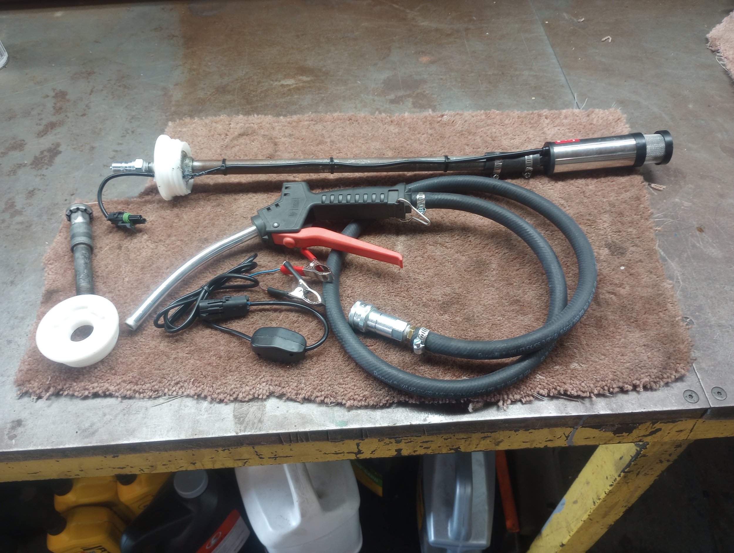

I hate using 5 or 6 gallon diesle fuel containers to fuel my JD and Kubota tractors, so I've been looking for a 15 or 20 gallons barrel to make a portable fuel caddy. I mentioned it to a friend, and he gave me a plastic 15 gallon barrel that he had no use for. I rinsed it put with water, then with some gas, and then finally with some diesel fuel. I had bought a small submersible pump a couple of years ago when I first came up with the idea, and bought a couple of new plastic bungs with the proper buttress thread to fit the barrel openings. With a bunch of other parts I had on hand, I assembled all the necessary fittings including a quick coupler so I could remove the hose and nozzle when putting it in the truck to fill it up.
I was trying to decide on how to power it, when I remembered that they make adapters to attach to various power tool batteries to power other items, so I found one on Amazon for one of my 12 volt Dewalt batteries. I wired it up to the pump switch and added a Weather Pack connector so I could remove also, it when refilling the barrel.
I also added an inline filter for good measure.

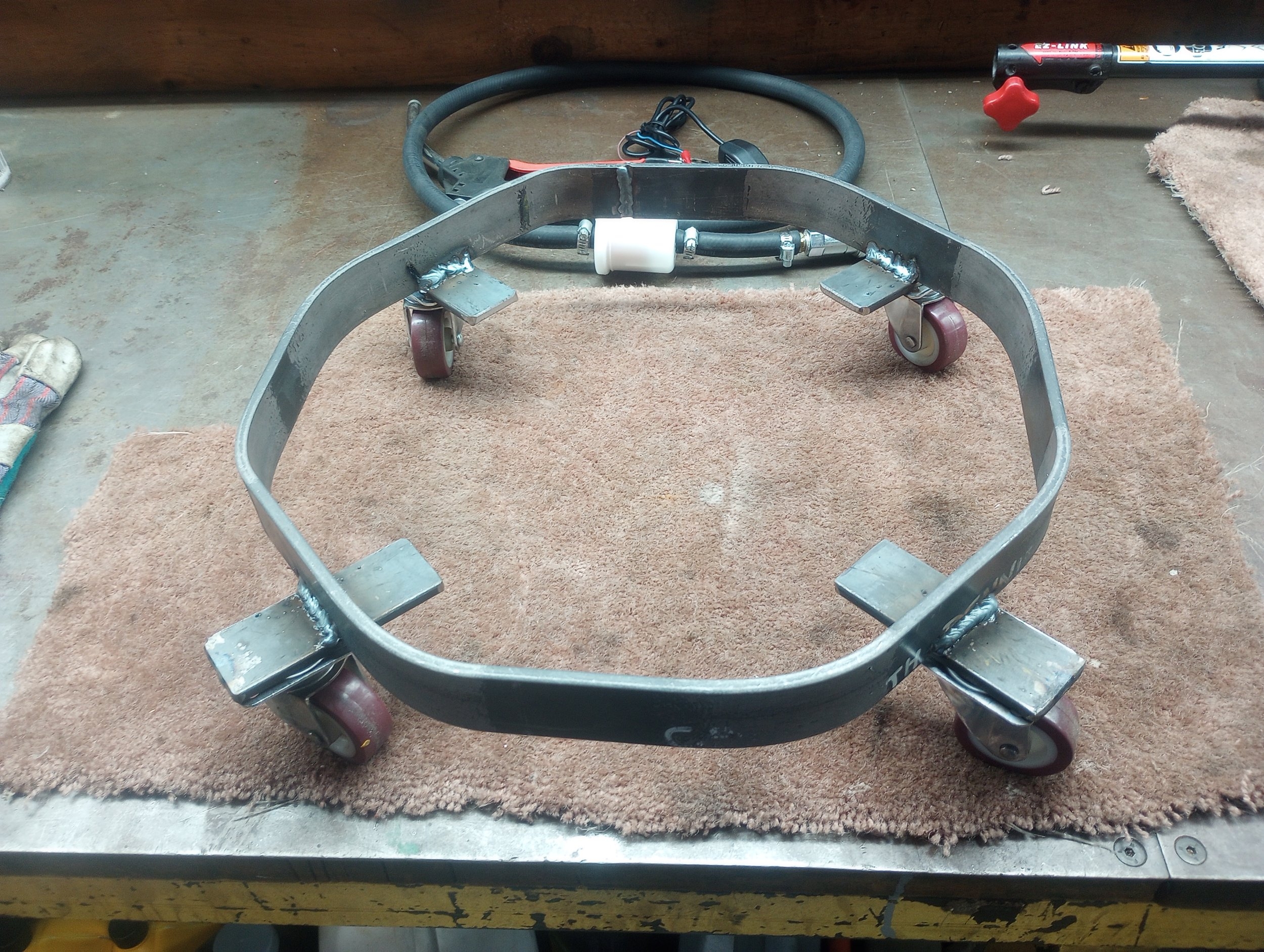

I also made up a carrier out of a piece of 1 1/2" X 1/4" bar stock bent into an octagon and casters I had on hand, then gave it a coat of Kubota orange paint.
I got it all together and filled it up at the Co-Op Saturday, used the BX to lift it out of the truck onto the carrier. I plugged the battery into it and gave it a try, to top off the tank on the BX, and it works fine, just not really fast. It probably only pumps a gallon or two a minute, but that's fine, still beats wrestling 5 or 6 gallon cans.
Another one of my many little projects finally built and working.

That's an awesome solution and I particularly like your octagonal cart.(y)
