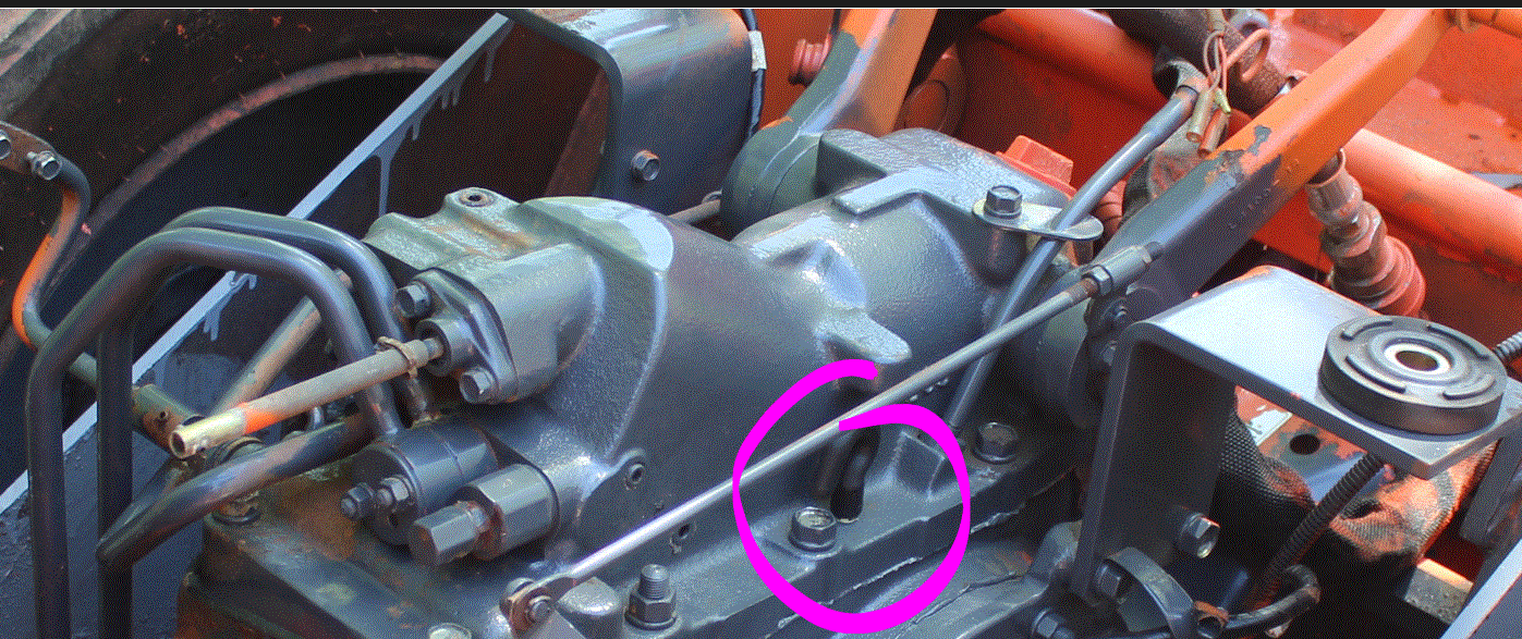

On my L35, I've got a front axle breather tube and on the rear transmission/differential, also a tube breather.
Picture of rear for example:
