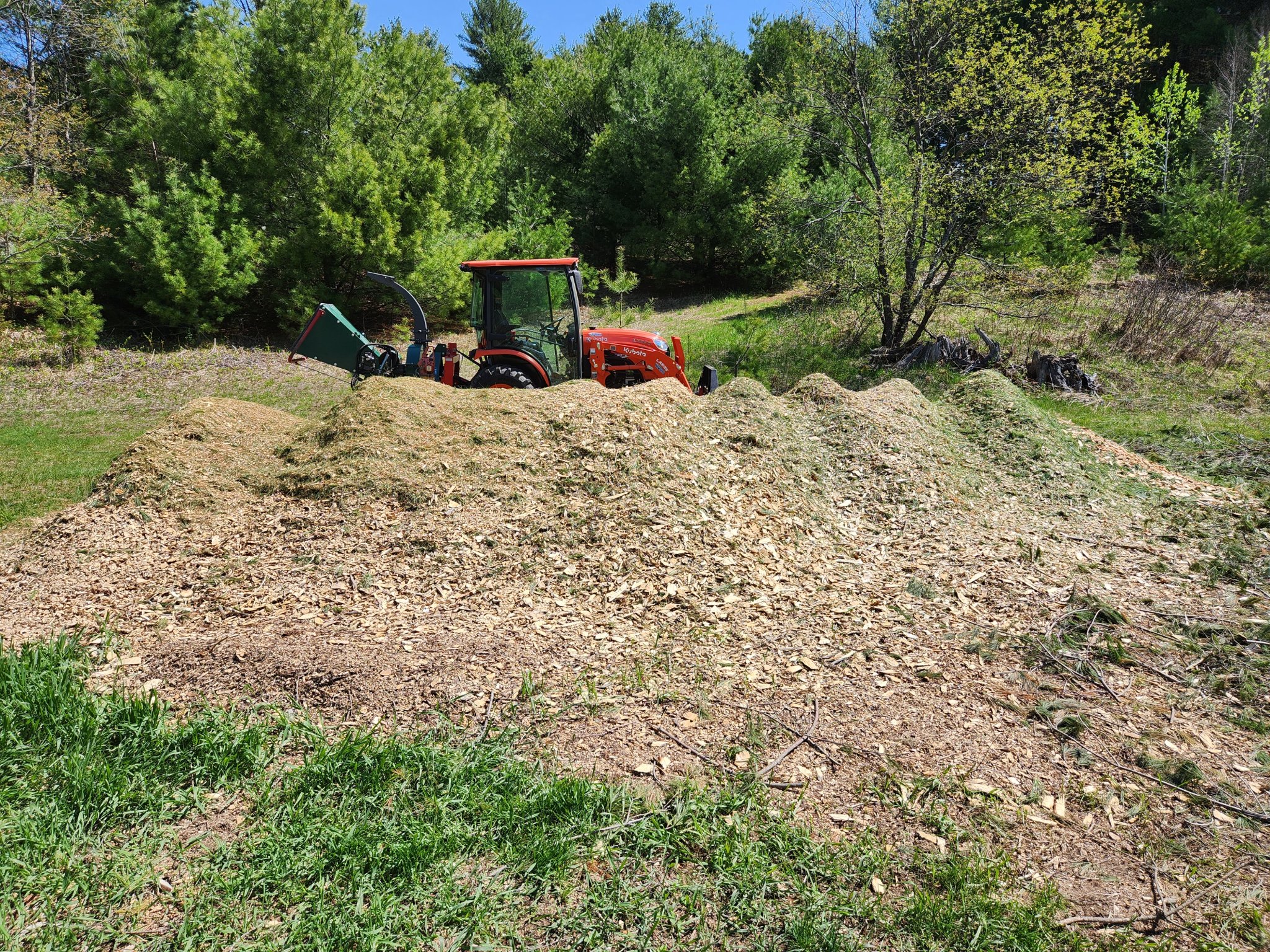

I run a woodland mills wc68 chipper on the back of my lx2610 with no problems. I also have a flail mower that I use to maintain trails around our fields.

I'm running a Woodland Mills WC68 chipper very nicely behind my B2650! And that's NOT W. M.s smallest 3-point chipper.
Don't let that dealer's doubts about running a chipper with our basically-the-same machine dissuade you from considering the LX2610. The WM68 eats branches and logs up to 6" green as fast as 2 of us can stuff its chute full.
Plus from 6 years with my B2650 and 119 acres of various meadow and forest/bush in a climate that gets lots of snow and plenty of heat now too, SE Manitoba, it eats the snowbanks with the 63" B2782B blower just fine as well.
