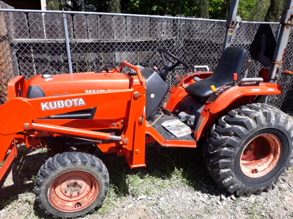

Hello,
New member, first time poster here.
I recently picked up a 2006 B7800. It was bought and left outside for several years up on the coast and although it only has 90 hours, there is quite a bit of body rust.
The fenders are actually rusted through in a couple of spots and there is surface rust on the arms and hood.
The tractor runs great and I just did an entire service for grease, fluids and filters.
I'm planning on sanding, priming and painting the rusted areas but will probably need new fenders at some point.
Anyone deal with this before? Thoughts, advice, comments welcome....
Thanks in advance

This is an excellent product. I put it in a spritz bottle and spray on rust. It neutralizes it rust and puts a seal you can paint directly over.

Thank you and yes, under the floor mats wasn't as bad as I expected compared to the fenders, lift cylinders, and other metal parts.....maybe the rubber actually protected them a bit

do it right ...cut out the rusted areas 1/2 more than the rust, weld in new tin, same gauge as panels,grind flush, use epoxy primer, paint
NONE of the so called 'rust stoppers' will work for long.Yeah maybe a month or two, maybe a year, certainly not 5-10-20 years, not in Rustario !

yeah, at this point, I'll be sanding, priming and repainting the surface rust, will probably use rust stop products on fenders until I can find a new/used set to replace them with....

You can sand forever and you will never stop rust. Just get it smooth and coat 2 to 4 times with rust killer. there are several good ones on the market. As long as it turns the rust black you have a good one. For the holes fiberglass is your best bet. Paint on a coat of glass stick one or 2 layers of cloth over the hole while it's still wet and paint on 2 more coats after that dries. Sand it out and your good to go.

If there is rusted through places probably the easiest solution would be to replace the parts if you can find them. If not go ahead and take it down to bare metal so you can see how much you need to cut out and weld new metal in. The rest of it take it completely down to bare metal and treat it with phosphoric acid and rinse. Then prime it with an epoxy primer before using any body filler. Epoxy has a recoat window usually around 8 hours so when you get the body work done prime it again with epoxy primer. Any of it that needs no body work you might use a filler primer right away. That is sandable and would eliminate the recoat window. The paint I would recommend MBC acrylic enamel which is made by Pittsburgh Paint.
