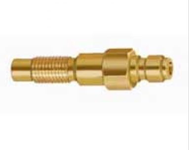

I recently went needed to test compression on a D722 engine also. I found that the properly sized glow plug adapter had a quick connect end that is smaller than a normal air quick coupler. I searched everywhere and it seems that it might be a proprietary fitting that only fits the Kubota compression gauge. None of the compression tester kits I checked had an adapter that would work. Frustrating!
I found, however, that paint ball guns use the same connecter. Ordered one of these and it worked great! https://www.amazon.com/gp/product/B0094TZVKC/ref=oh_aui_search_detailpage?ie=UTF8&psc=1
Good luck.

I think the D722 requires a smaller fitting than the one in HF kits. True, at least, for the kits in stock in my area. The D722 requires an 8mm - 1.0 fitting for the glow plug hole. Here's a link to the one I bought:
https://www.toolsource.com/engine-s...sion-test-adapter-8mm-100-kubota-p-97782.html
You'll notice the "quick connect" end. I didn't even think about it being a different size until I tried to attach to my gauge. I didn't even know there was a smaller quick connect fitting! However, the paint ball adapter worked fine.
I also tried to find a fitting in several kits for the injector port to no avail.

Holy cow! I know this post is over 2 years old but Delmar just saved me a butt load of frustration.
I too just purchased a Harbor freight for my D902 engine (same super mini series engine as the 722) and found that the couplers that came with it would not fit my M8x1 heat plugs. I also found the same link for the same M8-1 fitting which I am about to purchase.
Never in a million years would I have figured out the paint ball gun connector! Come on guys. This type of detail is in need of a sticky! Had I not accidentally stumbled across this thread, I would have run through all sorts of additional pain. Is there any moderators that collects this and post stickys for the different generation kubota's?
Anyways, big props to Delmar for the huge hint! I owe you a beer!

I don't think your understanding...The glow plug adapter is a special adapter that is 8MM on the glow plug side but a quick connector on the other, a 1/8" NPT thread would not help him in the least. ;)
EDIT: I get the confusion as there are 2 links posted, the second link is just a coupling, not what he needs, this is what he needs, first link:

I ordered this item and tried to use it on my B7500 engine (D1005) ...the threads were not a perfect match and I did not want to screw up the threads on my tractor... ordered another one but it was shallow against the head....I could not get the gauge hose to properly fit to get a good read....any one else know a better adaptor?
