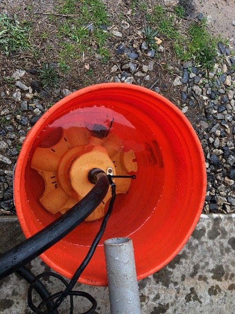

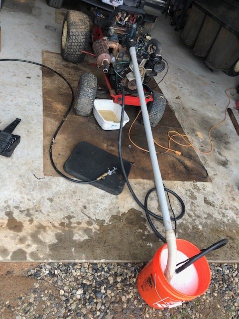

Okay, yesterday I rigged up a flushing system after I removed the thermostat and radiator. I pumped CLR into the water pump and ran the outlet back to the bucket.

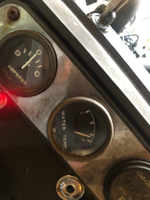

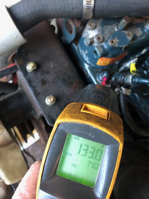

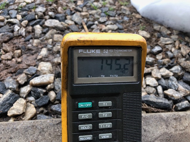

I ran that for about an hour and decided to run the engine with the cleaning solution circulating. After about 5-10 minutes of run time my temp gauge almost pegs but my circulating solution is only about 145. I IR scanned the block in several places and it reads about the same temp.

Looks like I may only have a gauge/sensor issue.
