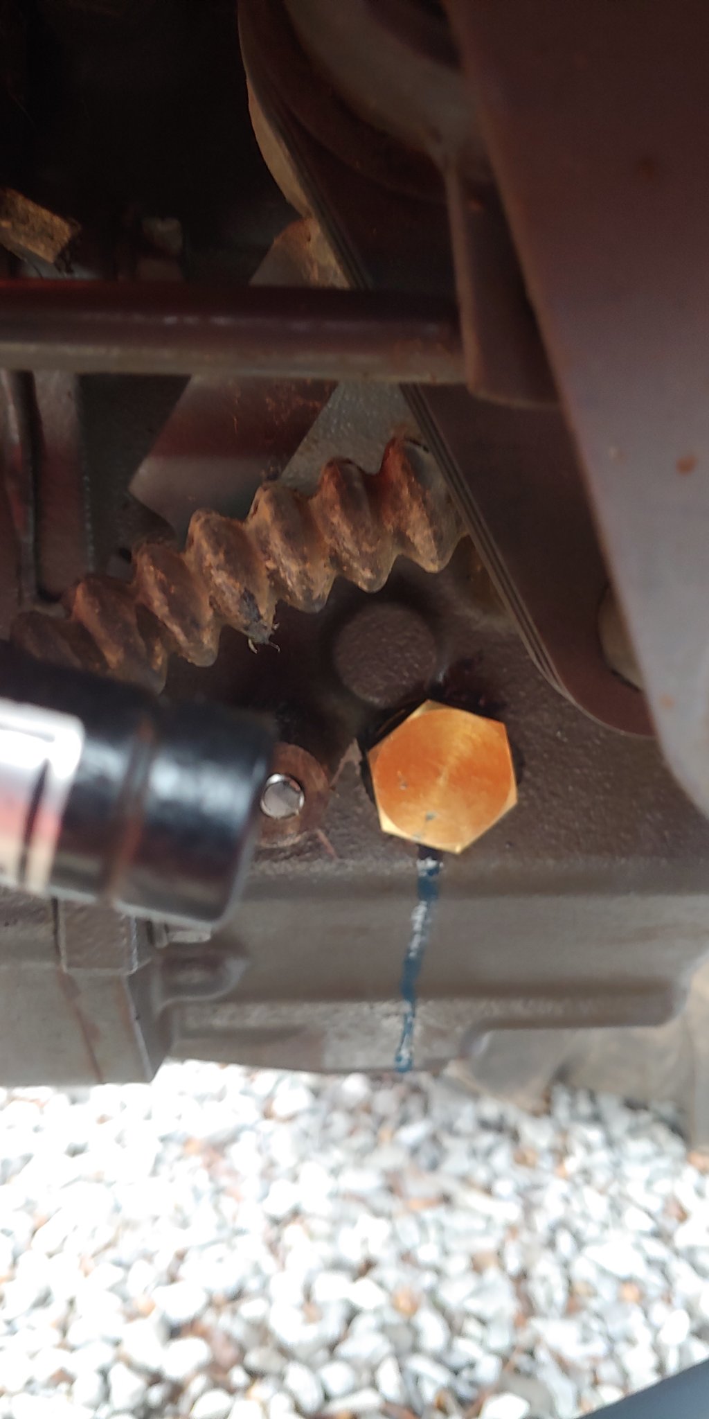

So the other day, I started my MX5200 hst and noticed the drive whining and not wanting to move. I thought it was just due to the cold spell were having. I took it up the road and back but it was a challenge.
When I got back I checked the trans oil and it was not in the glass. Looked for leaks and didn't see any. Weird!
So I go get 5 gal of fluid. Start pouring it in. Still not showing in the sight glass. And now I notice oil is pouring out of the trans. So underneath to investigate. And I see a bracket that has been ripped off the trans side, along with a hole in the side of the trans and a steady stream of my new oil going down the gravel. I have some pics below.
So my options were to have it welded up. But I would have had to take the rear end off and take it into a welder as I dont think they could have welded it in place. Or buy a new housing? Don't think so. Or me route.
Remove my filled rear tire and wheel.
I drilled out the crack and hole to 29/32, tapped to 3/4 npt, bought a brass plug, applied Loctite and screwed that sucker shut. The bracket, I haven't replaced yet. It held a spring that provided tension to keep the cruise control lever in place. That will be an easy fix when it warms up a bit.

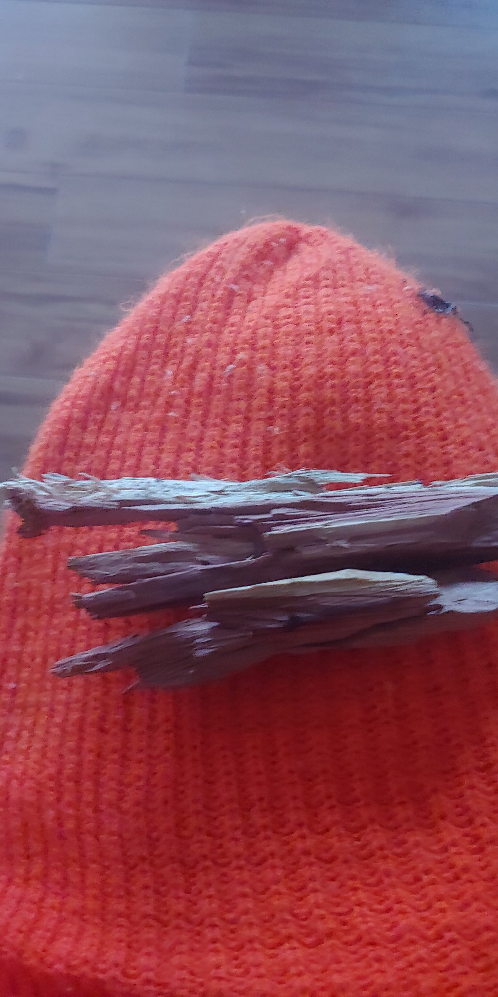

No leaks after replenishing the oil and everything is back to working normal. Oh and that piece of cedar wood is what sheared the bracket off.
Well that's my story and I am sticking to it.

Your "story" documents an innovative solution deserving of a 2022 Nobel prize !!!

That is a really awesome fix. I am sure that you thought of checking the filter for metal shavings from the drilling and tapping that you did.

What did the bracket do, or more importantly what doesn't work now?

Wow, nice write-up and repair!
Re-adding the spring/mount later when weather is better is a good idea.
Your machine is usable right now!
That Lock-n-stitch is pretty nifty too.

Nice fix. Would it be possible/practical to use the brass plug as the new "boss" to remount the original bracket?

If you plan on using the plug for the original bracket mounting, I suggest that a steel plug might be stronger than the brass. I would forgo the cruise control and not mess with the new "drain" plug. Anything that you attach to that plug might suffer the same fate at some time in the future, and it might not be as easy to repair the next time. You did a great job of dodging a bullet, so don't gamble your luck away in the future.

I was thinking the softer brass may act as a "fuse".

I think I would not take a chance with replacement of the bracket unless you could make a shield to protect the bracket, so it was not a reoccurrence. Even better would be away to fasten spring to something nearby with a zip tie.
4,213
819
Can you make the bracket be the weakest link by using weak material and then sawing through it partially?
