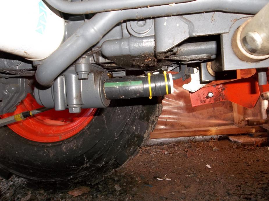

Mine didn't come with one for the mid PTO. I use a piece of heater hose with a cap off WD40 or some spray can taped over the end of the hose.

Mine is like 07Wingnut's. except I used heater hose. It fits nice and tight.
Little longer than it needs to be but doesn't matter for me. I just want it to keep the splines clean.
