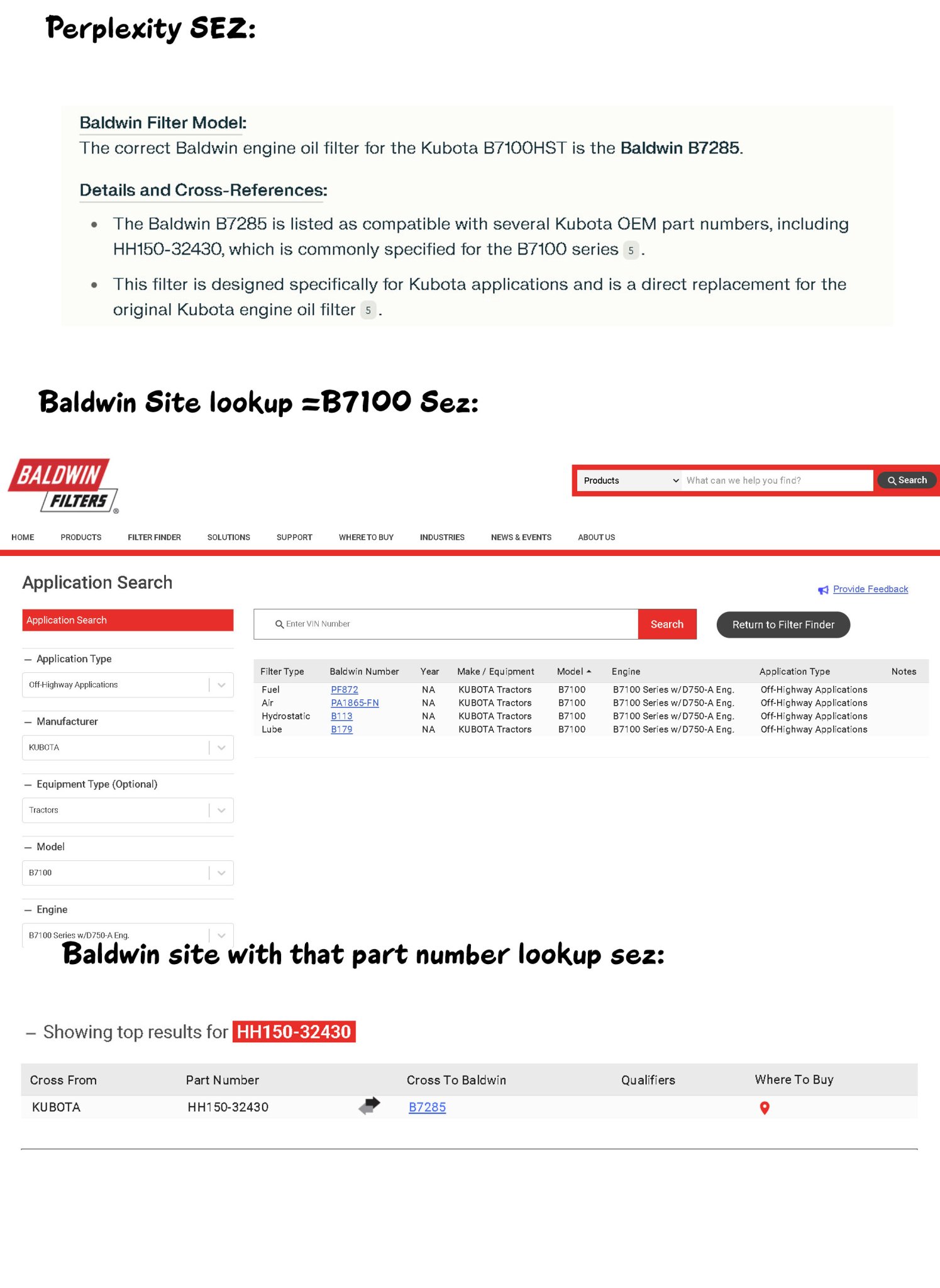

OK I got a B179 before I had to Double-check and wasted my time. And yours...
I'll change it soon..
THANKS!
I have used the B179 on all 3 of my B7100's - never a problem - as a matter of fact, many of the kubotas at work use the B179 - I have like 6 in hand waiting to change them at a moments notice.
Very good filter
