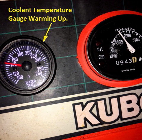

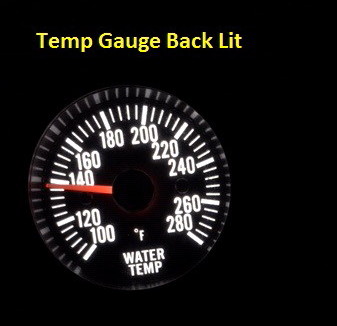

There are any number of lights or light/buzzer combinations that you could install along with a temperature sensor to engage it. It would just involve a little wiring and finding a place to install the sensor.
Personally, I just monitor the analog temp gauge I installed on mine, so I know exactly what the temperature is. A quick glance down ever so often confirms things are OK.

Does this temp gauge work off of the original engine temp sensor, or did you have it install and additional temp sensor. And if you did install a different sensor how did you do it?
Flintknapper
L2350DT
May 3, 2022
1,929
2,434
Deep East Texas

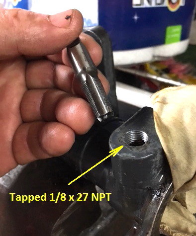

MY tractor (not the same as yours) never had a temperature sensor to begin with, so naturally I had to add one. But IF your tractor currently has a sensor mounted on the engine/cooling system, you should be able to use it.
I drilled and tapped a spot for my sensor in the water jacket and installed it there.
