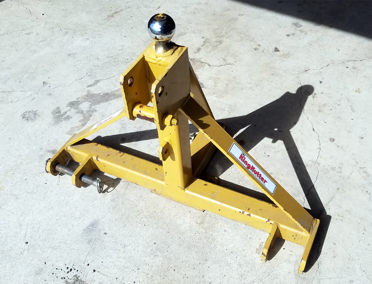

Here's the King Kutter reciever that I bought for $50 and a stock photo showing the other side.

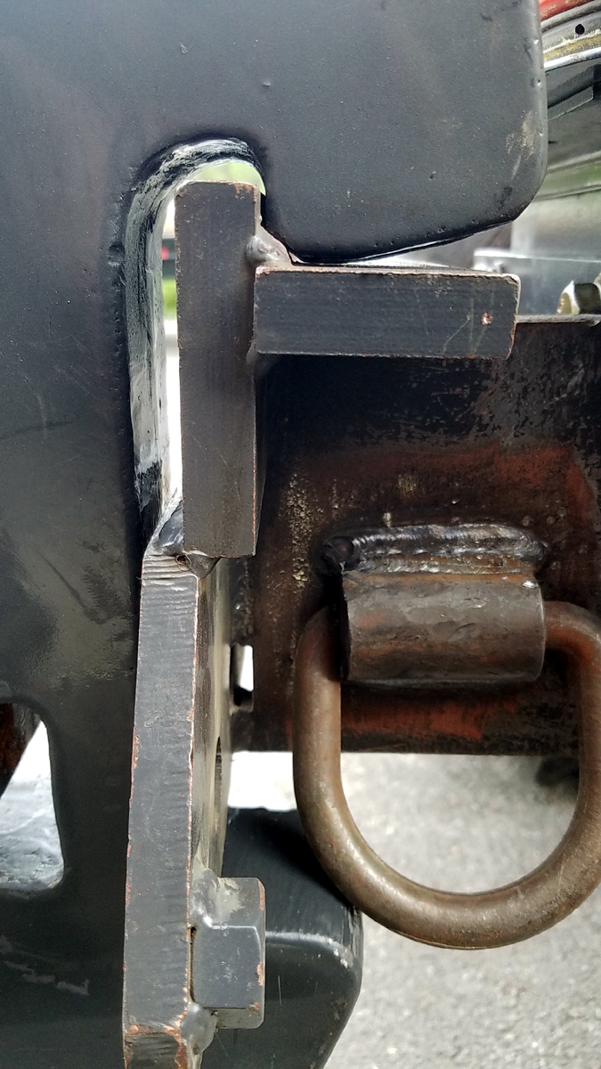

@sgr, that's very kind but I need to be able to hang ten of these 102lb weights. Earlier in the year I realized that I needed to grind the underside corner where the weld was interfering with it to get the weights to sit down on the bracket. It's a Kubota bracket but the weights are sold by Everything Attachments and are made in India so any "out of the box" stuff that works would mostly be luck.

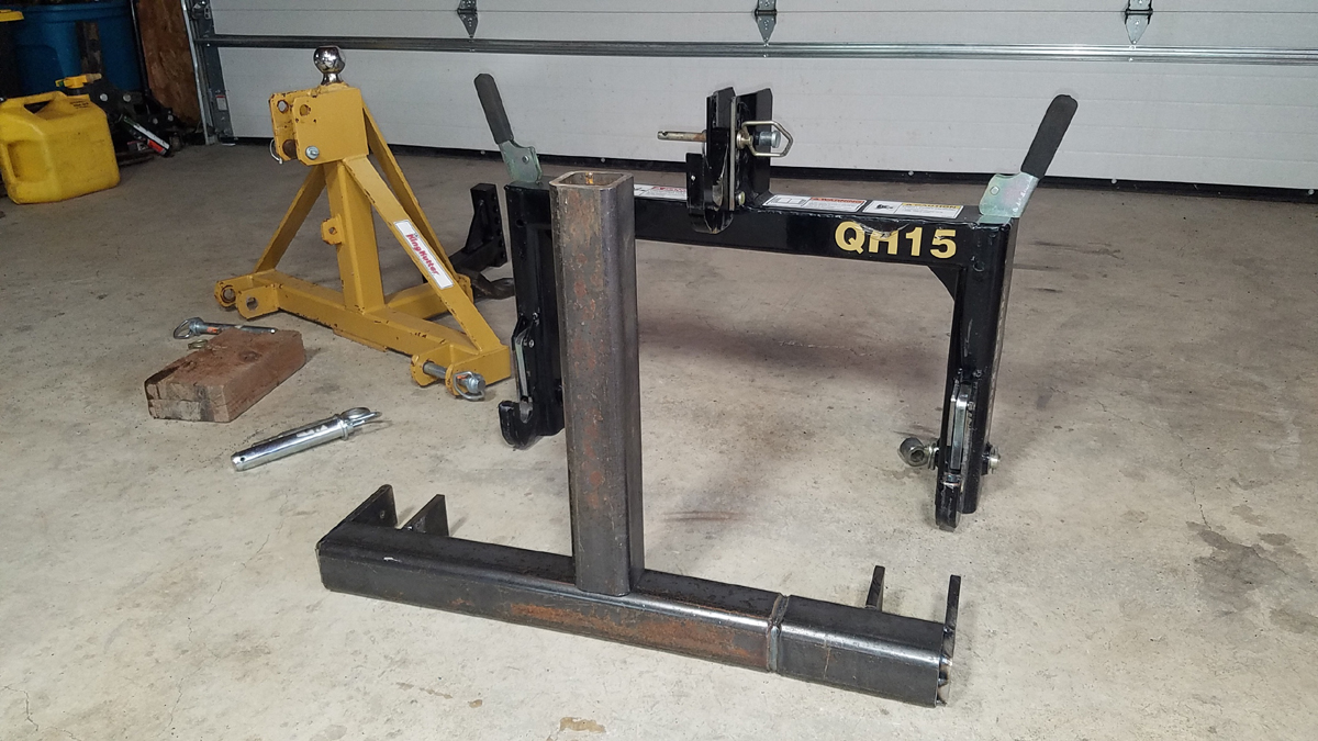

I've decided to make a suitcase weight holder/rear ballast from scratch. I cobbled together some 3/8" walled 3"x3" tubing from another project, cut some plates and started on a new implement. I'm copying some of the features of the King Kutter that I like and will follow up when the project is further along.

Yeah, and I wasn't feeling great about messing up the King Kutter in a big way. I have enough scrap steel laying around that I should be able to make something half decent that does the job. It'll be overbuilt as usual. :LOL:
