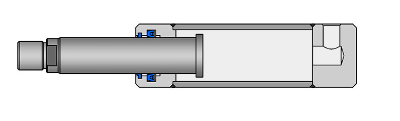

One thing that is not obvious at first is that due to the cylinder rod, if it is to go into the cylinder, the oil it displaces must do somewhere. That is back to tank through a leaking control valve. Without an external leak, no place else to go.
Why doen't it just go to the other side of the piston?
6,889
3,327
Because there is not enough room for all of the oil that is being displaced by the movement of the rod.
When a cylinder retracts the volume of the base end decreases faster than the rod end increases. Its hydraulically locked and cylinder cannot retract seal or no seal.
When extending the opposite is true. Volume of the base end increases faster than rod end decreases and oil can bypass around the seal allowing the rod to drift outward.

While I agree that ALL the oil can't bypass to the rod side due to the volume taken up by the rod, it's certainly possible that enough will bypass to allow the blade to move until the tracks are back on the ground.
With the blade and tracks all sitting on the ground, there's still travel in the blade cylinder to pick it UP for travel.
6,889
3,327
No oil will bypass internally because the cylinder is 100% full of oil. For the rod to move inward in any amount the volume of oil inside the cylinder has to go down - period. If you completely remove the piston seals on a double acting cylinder it effectively becomes a single acting cylinder as shown below. Think about it.
Either the valve is leaking internally (see post #15) or there is an external leak in the circuit
