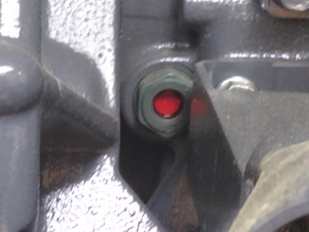

Receive my JD hydraulic fluid dye the other day. The bottle it came in was about 1/3 full and the instructions do say to empty the contents into the hydraulic reservoir. I'm guess there was about 2 oz?
Definitely works.
