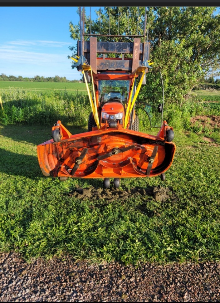

S-G-R
LX3310, LA535, rear remotes, third function, R14's
Jun 17, 2020
895
1,589
PEI Canada
This what I found to be the best way to clean a mmm and while I had it, I never found anything that would keep the grass from sticking.

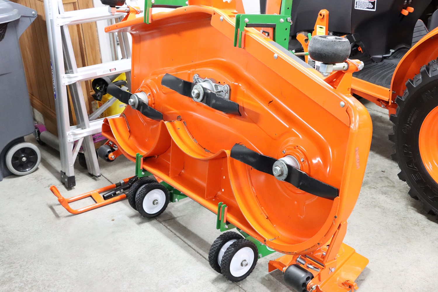

WhitleyStu
B2601 LA435 FEL 60" MMM 60" Snow Blower FSP500 Spreader 5' Grahl Roller 40 spray
Sep 10, 2020
58
102
Indiana
I mow roughly every ten days and don't like having the mower on when using the tractor for any non mowing chores. I keep the deck on a Deck Dolly when not in use as it makes it much easier to clean and change out blades. I am on my third year with this mower and the deck bottom is still in fairly good condition. I spray the deck with WD40 after the occasional pressure washing. It is missing some paint, but the WD40 seems to inhibit rust on the missing paint spots.

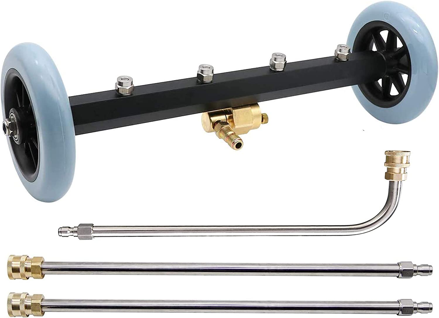

TomRC, since you have a power washer here's a $35 attachment that does am amazing job of pressure washing without getting dirty. I bought one to clean the underneath of my truck after the county gets done putting dust control solution on our road.
You can push it under something and not get a bath. You can also turn it over and clean you concrete sidewalk!
Well, that is pretty cool and surprisingly cheap! Just buying those extension wands in the store alone are quite pricey! I can't tell you how many times I have heard someone say their really nice looking shiny car wouldn't pass inspection because of all the rust damage on the underside of their vehicle! That brine solution they spray on the roads does lots of dammage $$$$$! Our new car wash up the road will clean the underside of your car. After a good wash every spring I try to spray any area with rust stating to form. Any welded area and cheap metal fasteners are first to go!
