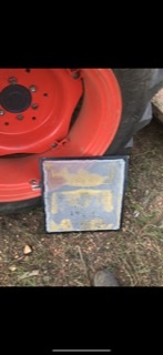

I put a cheap air conditioner filter in front of the screen to help keep it clean and then shake the filter off when needed.
There is a filter that is blue plastic without a frame around it that works great. Also one that is fairly thin with a cardboard frame can be forced into the area but not as easily as the frameless
Filtrete brand if I recall but didn’t see them on the website but I purchased them at Home Depot or Lowe’s
