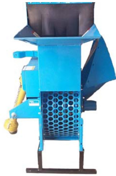

I've been very pleased with the MacKissic TPH185.
I use it with both an 18HP and a 35HP tractor. 35 is a bit much, so the "economy 1000 rpm pto speed is used with reduced engine rpm.
Damp soil though the shredder is a problem with sticking to the discharge screen. Having a supply of woody material available to clean out the grill goes along with running "compost". through.
Chipping up to 4 inch material goes quickly. One large branch at a time. side branches must be trimmed to fit the input port chute.
I've replaced one drive belt and flipped the shredder hammer. flails twice. They need flipping one last time to present a square sharp working edge. stones dull the flails.
I've sharpened the pair of chipper knives several times. The "smoke wrench" is a necessity to get the fixing screws out. I bought a box of 100 replacement internal wrenching c'sink screws for service replacements after sharpening.
The unit is not too large or heavy. Does what I require, The outfit is still in business should parts be required. None so far, I'm on year 7 or 8. CRS.

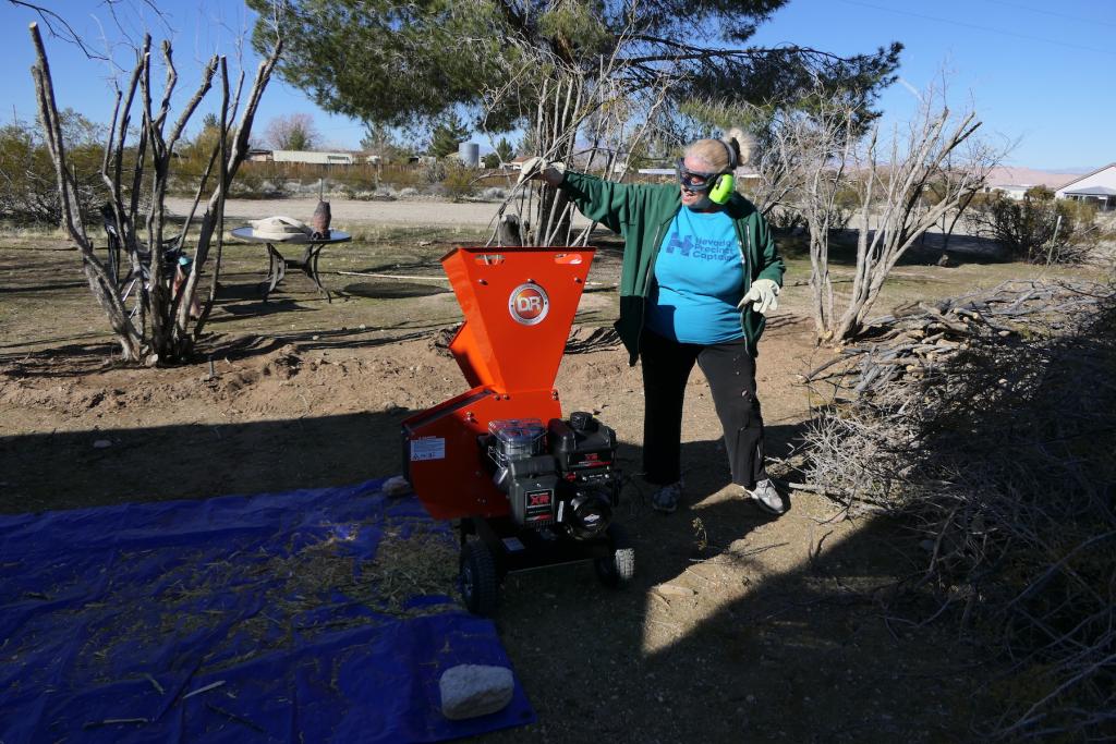

We have a DR Pro400 electric start chipper/shredder that we like. It's a manual feed so chipping is slower and vibrates the hands. Shredding is super fast and easy. For it's size, it's a beast. We got the tow hitch kit.

It's knives that can rotate around a shaft. Several shafts and a rotating drum. At the bottom, I have 1.25" hole screen - you can get smaller screens to chop up to finer pieces...
That pictured machine has knives fixed to a disc on the end of the central shaft for chipping.
It has swinging hammers, flails, or you can call them knives on the drum pins shown in the image.
They are just flat steel about 1 1/2 inch wide, 6 inches long and 1/4 inch thick.
Two holes drilled to fit the drum pins and allow "flipping" to present a square edge.
They do not "cut" like a sharp edge knife, rather, they beat the material into small pieces.
SHREDDING large and fibrous material. crumbling friable stuff, and throwing rocks to kingdom come! ;-)
Regarding tractor size and input power. The MacKissic unit has a poly v input belt drive in a "speeder" configuration. Excess input power will slip the belt, a Jamb will either throw the belt off the pulley, or smoke you out. ;-) Self limiting.
