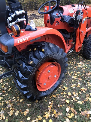

Hate to admit this, but at the beginning of the summer I swapped AG tires and rims over to turf. Last time I mowed I hoped off the tractor to pick up a branch that had come down and notice only two of six lug nuts holding a rear tire on and the remaining two only had a couple threads holding them on. I'll be adding "check tires aren't falling off" to the preflight check list along with check air pressure.

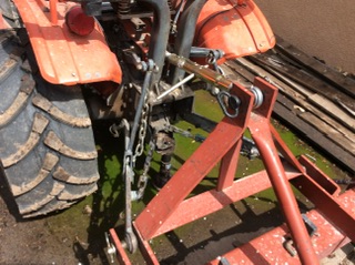

Good post Yooper. A similar thing happened to me when I had my tractor at my wife’s aunt’s house repairing a retaining wall. Low pressure in the right rear tire and all the ballast leaked out as well. PITA to pull the tire, take it home and refill with ballast and get the bead reseated.
Hey, you had the Box Blade on, that made it a lot easier than without!!

Hmm not sure what difference having the box blade on does?
Probably mistaken about the 3 point hitch having down pressure. Wouldn’t that be nice.

Brain fart. The 3PH has no downforce. I was thinking of the landing gear on the backhoe.
The photo may look like the box blade is supporting the axle. I have a jack under the center tow hitch. Hard to see it in the photo.
When you post a photo you should have the choice to post a full size image. Your pics are very small.
