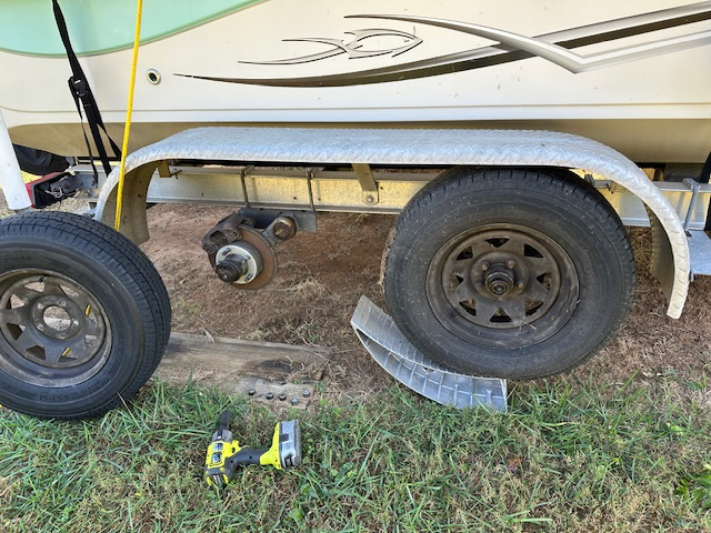

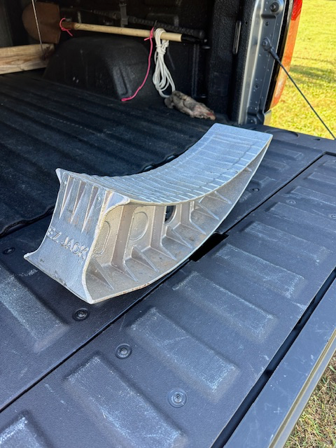

For those of you that have any kind of trailer with tandem axles this has to be the easiest way to change a tire I have ever used. I bought this and have had it stored in the back for years and never needed it. Well I discovered that one of the tires on my boat trailer had a failed plug and would not hold air. So this was the first time I actually needed the thing. Wow, definitely much faster and easier than messing with a floor or bottle jack.

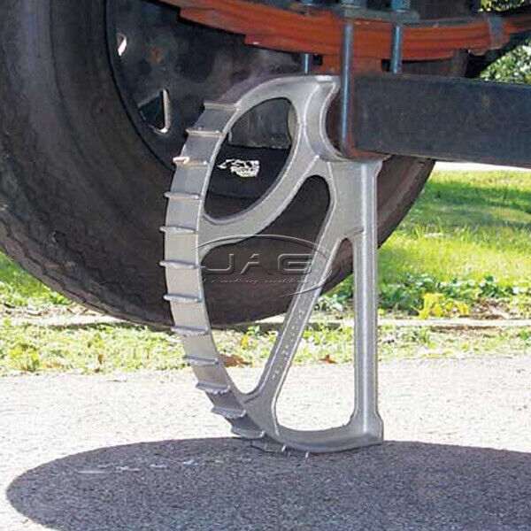

I have used this for years, similar principle, but under the axle instead of the tire.

The first one only works is you have a torsion axle, not a spring-hung axle. The second one will work with both.

I have one of those. Came in a camper trailer leveling kit I bought several years ago. The kit had two low rise things shaped like that for leveling the trailer at a campsite. Put them on the low side and pull or back onto them until it’s level, then chock under the ramps and chock the tires on the other side. With a spotter watching a level on the trailer it’s a pretty slick way to level a trailer in under 5 minutes start to finish.
The one higher rise block, which the kit referred to as a jack, looked like yours aside from mine is orange. Used it once. The one time I used it was on a Winnebago Mini 2801BHSS with leaf spring suspension. Agree it worked extremely well.
Yessir. Found that out the hard way. Now I carry a pneumatic bottle jack and hook it up to the onboard air on the truck. Took 15 minutes to change one on the side of the road. Then another 15 to find a hole in traffic to get back in the interstate. Lol!!

I have the same tire ramp that is the first one shown. I have had to use it a few times in the last 20 years. It worked perfectly with both of my travel trailers. Both trailers have sprung axles.

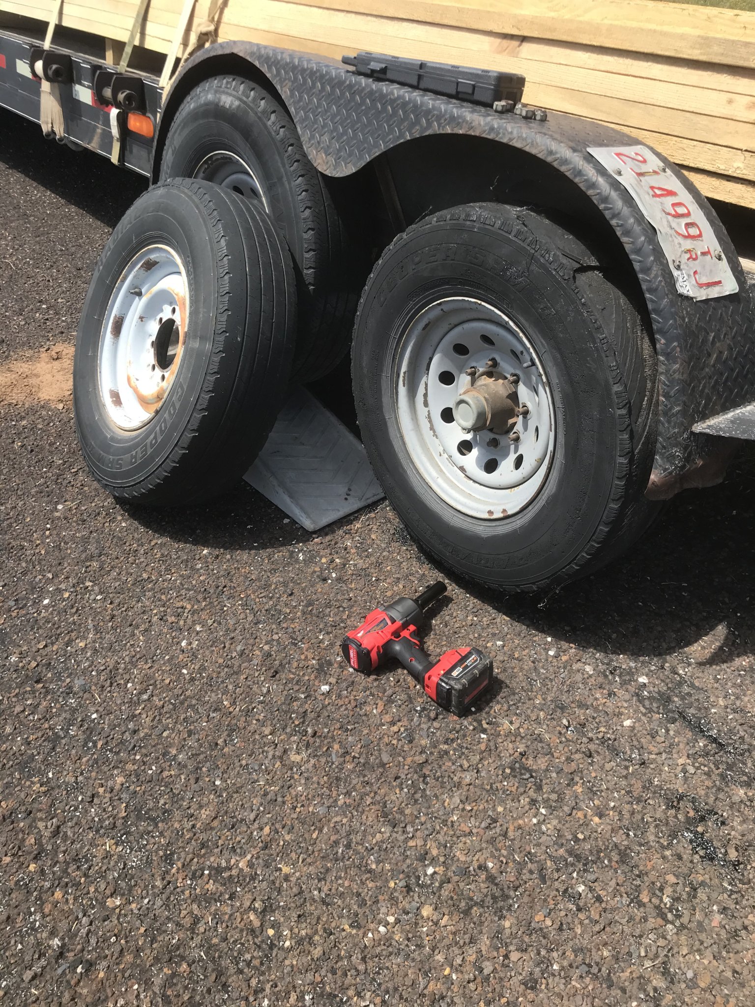

I found that there is too much flex with the center spring hanger. At least on a 13k toy hauler. Maybe if it was on flat solid pavement it would have worked.
Yeah, you can see where it had just enough room. That trailer was a skosh over 14k.
