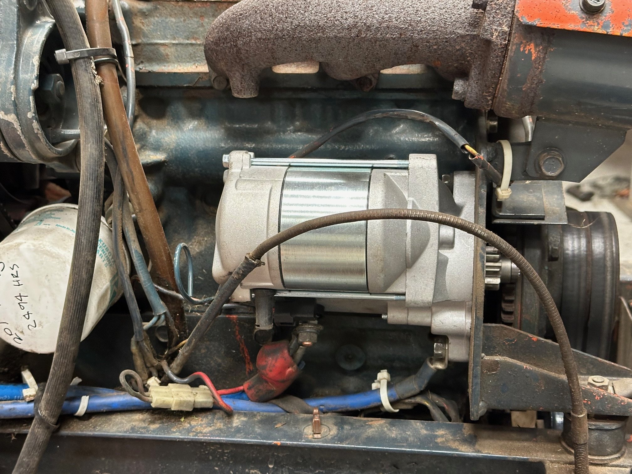

Over the last few years was having trouble starting the old beast (G5200). took a lot of slow cranking, battery seemed to be always semi-flat when I needed to use it. I decided to change the "working" starter based on some reviews I read- well its the best thing ever! Cranks even on a low battery in a few seconds- unbelievable.

I agree with comments for upgrading to decent battery cables- about 2 years prior to replacing starter (blue in photo). I believe the original starter was very tired and the engine too needing more cranking power than when brand new- for example my GR2120 starts almost instantly with a traditional non-reduction starter. G5200 still needs a few cranks(1-3seconds) - this where i found the advantage of the reduction starter for the older machine.
...by the way noticed reduction starters on some new tractors ....while browsing....
