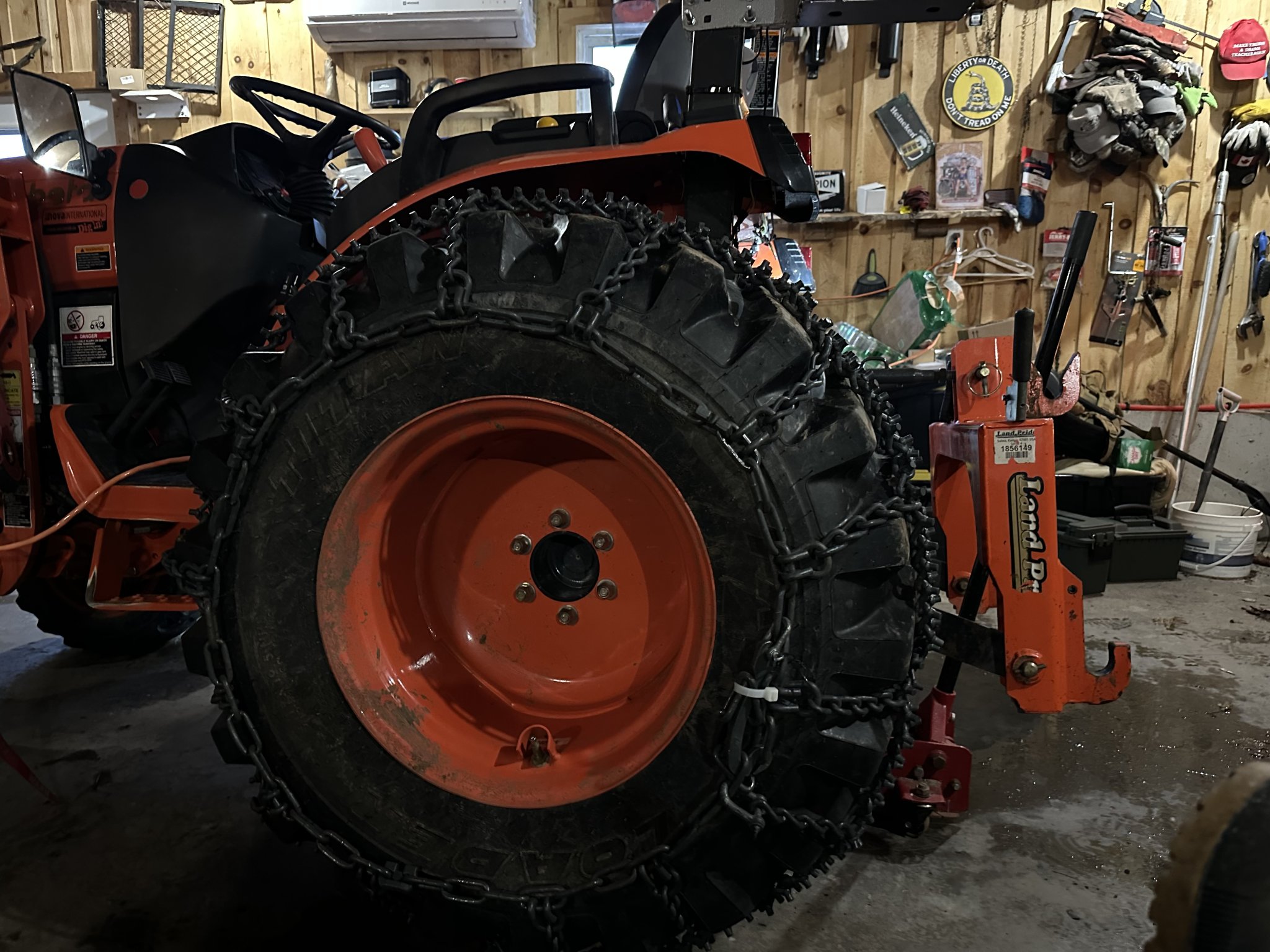

Sunday nights adventure convinced me it was time to install the new Trygg tire chains I had not yet unboxed from last year. Having never install chains of this size on anything I decided to warm up and ready for the process with some Youtube videos. Seemed simple enough, but it always seems that way. YouTube has really changed how many of us approach projects, mainly for the better I believe.
Seeing as it was Glenn’s driveway that took a few years off my life I recruited him to assist with the chain install. This led to him leading and myself, will I was demoted to assistant. Fine by me.
After rolling the first chain in to place, we realized we had to shorten it quite a bit. Good news is that part was pretty simple, removed two couplers and boom.
Next we linked it all together, and binded it tight. It’s a two man job for sure as I see it. Could I have done it on my own sure thing, but I recommend having helo the first time.
— The Results —
Went out today to test this bad boys out, Glenn’s driveway the site of my almost demise was the target. Let’s just say these chains turned the old LX2610 into a mountain goat, or gave it the abilities to climb just about anything. Did not spin the tires once.
Cannot recommend tire chains enough, I always managed without them but what a game changer.

You won't be disappointed with Trygg chains. Have had a few sets on different tractors and won't buy any other brand. Your puckering days are over. Nice job on the install.

Trbarlow,
Can I ask - did you choose to or need to add wheel spacers to your lx2610 for the trygg chains to fit?
I just picked up a new lx2610 and plan to order some trygg/aqueline talon style chains. I keep reading that spacers are recommended, but it looks to me like there should be plenty of room on my tractor.
