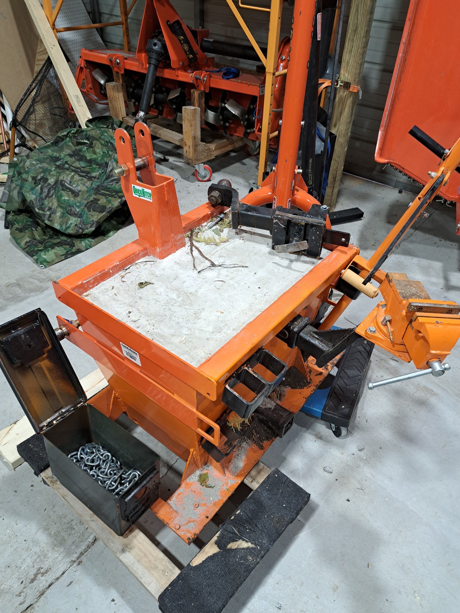

2x2x.125 will work.
I'd cut/ pin 2x2x.125 into the 'receivers'.Make the 'outrigers' say 24" long,or however 'deep' you want the carryall to be.
Now make the ladder frame ( yellow),same 2x2x.125, weld that onto top of the 'outriggers' when IN the hitch, and allow to cool BEFORE removing.
My 'carryall' uses forklift forks,makes it super easy to pickup skids of this, skids of that, transport here, there, anywhere. skids are free and I double stack them. EASY to pickup and only bottom one rots.
Honestly, you should try using sections of 2x2 tubing as 'forks' and lift a few skids of stuff.It could be the quickest and easiest solution.

I would plan to use the "Top-Center" receiver, so that you don't have to remove that "double ball" set up that you have going.
I think that I would go 1/4 inch wall....maybe 5/16....... just cause I like "over doing" things.....
Lots of very cool options to incorporate on a custom build.
One of my personal favorites is the " vise on a receiver' option.
I also used some 2x2 tubing and sliced it into sections and welded them on to carry shovels, rake...etc
Are you going to fill it with something or do you have "suit case weights" ?

Kind of like this.
