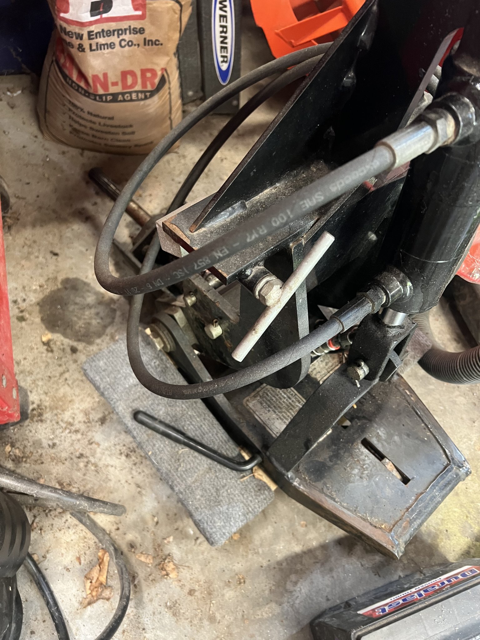

Hi , Just picked up a 2750B blower and frame yesterday and what I can tell is that it has the wrong frame for my tractor.
The data tag is not legible but po said it was off a b2400.
Does anyone know the correct part # or have one for sale Michigan / Wisconsin .
Thanks Mark

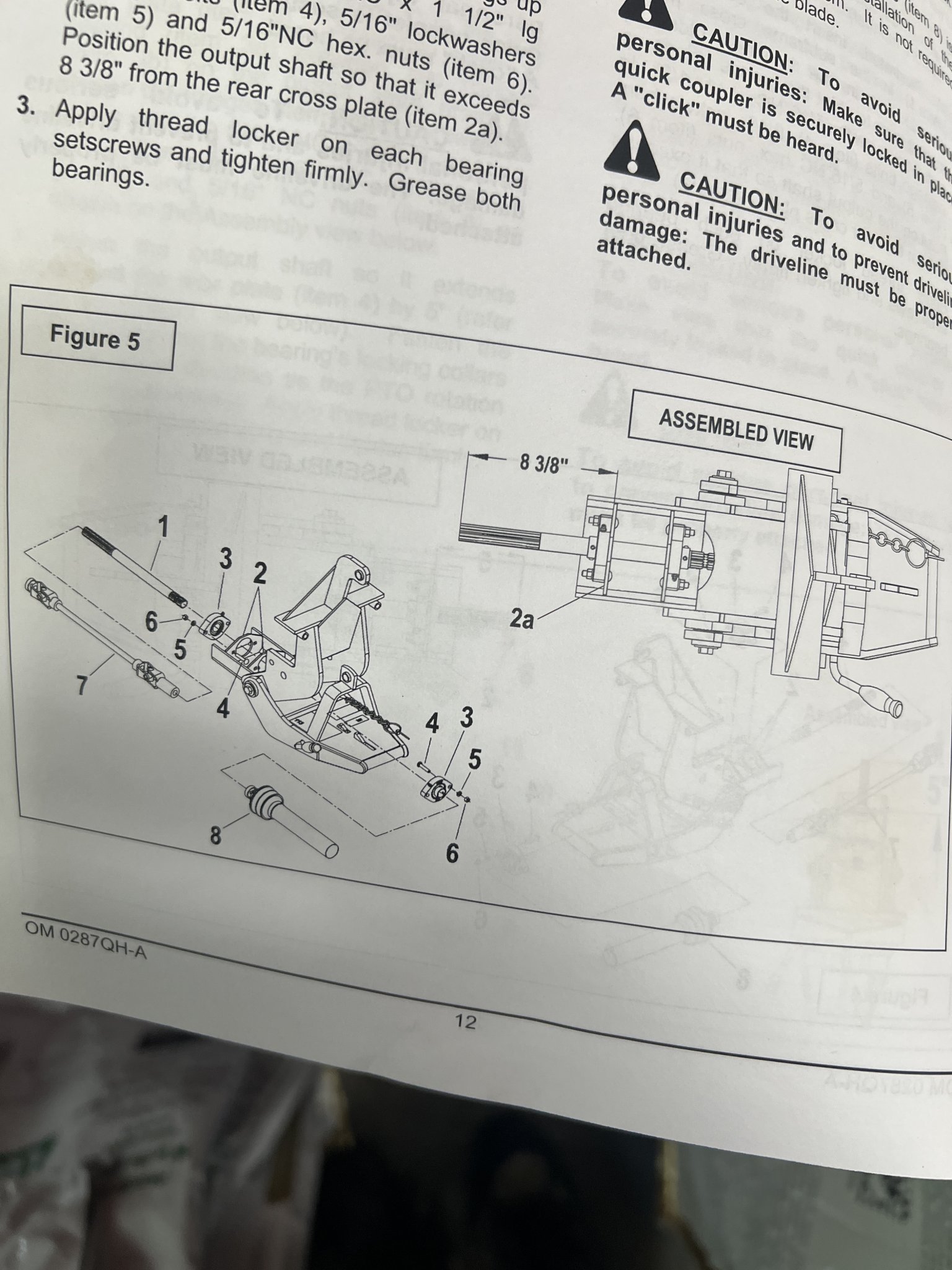

Mark - I’m not 100% sure the BX2751 is the correct hitch for a BX2230.
Not saying it’s incorrect; I’m just not sure.
The BX2751 is the actual hitch/subframe. My manual references BXxx50 series and 60 series, but not 30 series.
The BX2752 and BX2753 are the mid-PTO shafts. Should be one or the other I think as they’re the same but one is longer. I have the longer BX2753 on my BX2360.
Can barely see it sticking out the back side of my hitch.
There’s also a “driveline” that connects the tractor’s mid-PTO to the hitch’s mid-PTO shaft. That’s #7 in the diagram above. Didn’t measure mine but it’s about 36” long.
Is your BX2230 equipped with a loader? If so, does the loader valve come off the tractor with the loader? If so, there might be an additional bracket that the valve mounts to.

Thanks RCW , under Kubota parts it lists attachments for 2230 and the 2750 blower but no quick hitch . Guess I will have to call dealer .

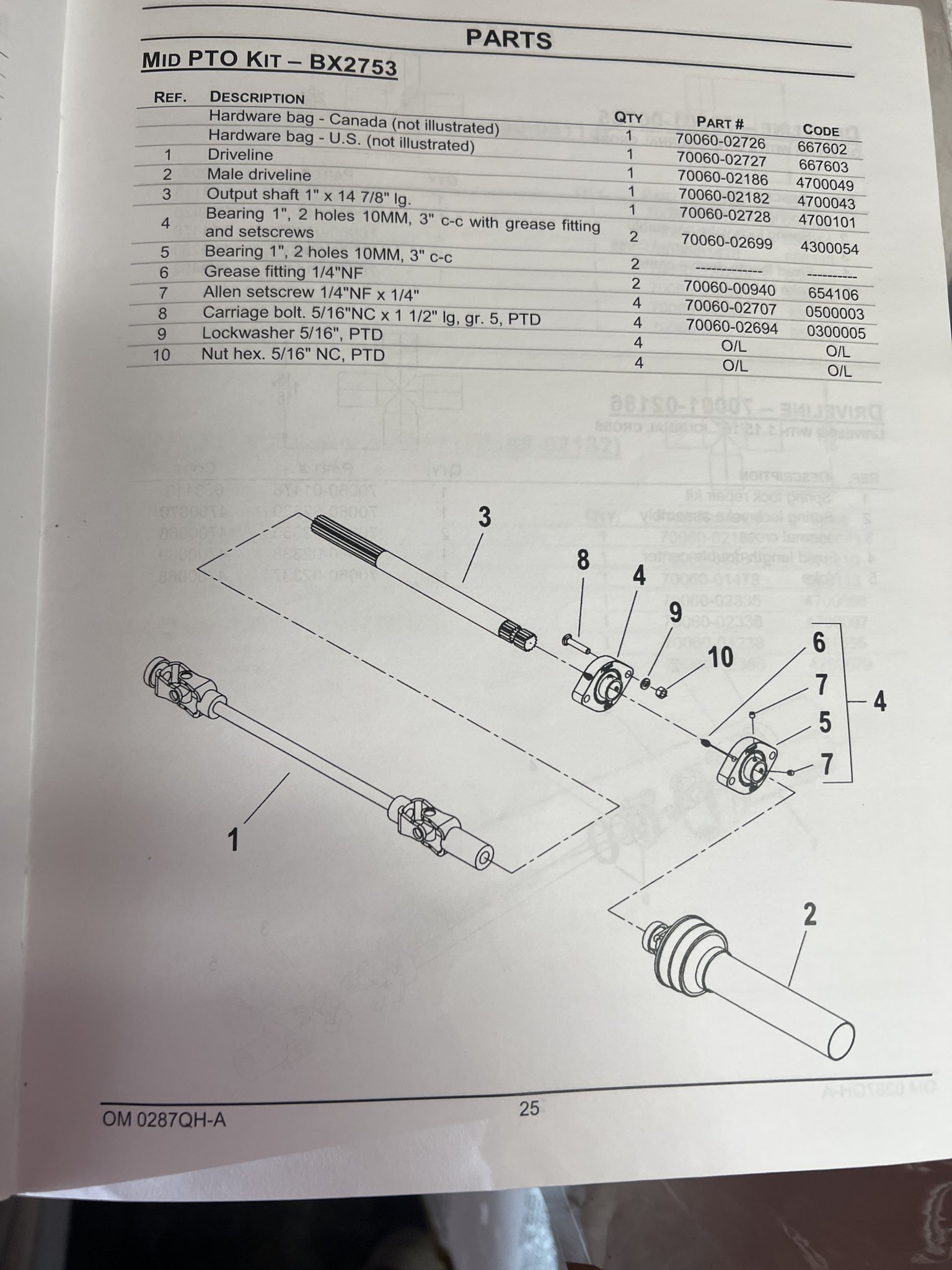

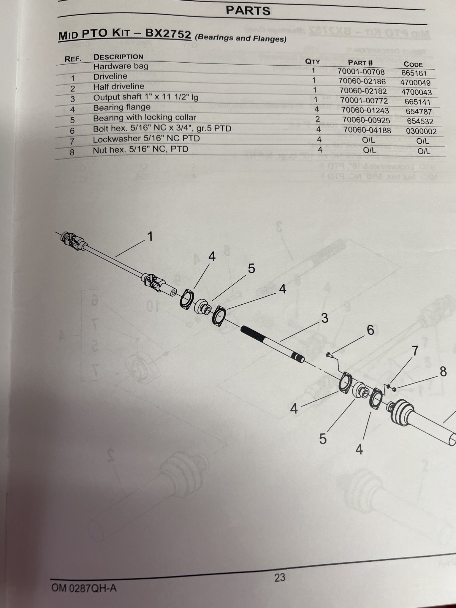

Here are the parts lists for the BX2752 and BX2753.
If you go that route, you’d want to buy the whole kit, not the individual parts. Just provide it for information purposes.
Has lengths for the output shafts and other useful information.
BX2752
BX2753
