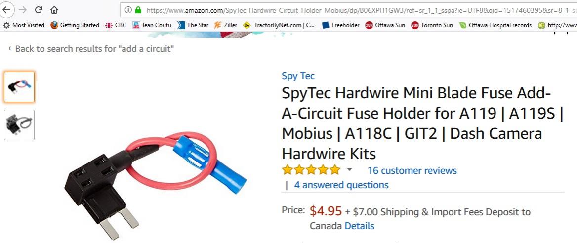

The easiest way, save for studying the wiring diagram is to use the "Add a Circuit," device.
It plugs into where an existing fuse is and adds another circuit while still maintaining the original circuit.
Because you get to select the fuse amperage for your voltmeter, choose the smallest one you can find.
Using an existing circuit limits your protection to a likely much larger fuse.
Dave

If you can find one that fits the add a circuit will work. I couldn’t. If I remember correctly, the BX uses micro fuses and I couldn’t find a corresponding micro add a fuse/circuit. If you are really set on not splicing into the factory harness, you could just extend the work light wire from under/behind the seat back to the front. Either way, I’d use a relay, and pull voltage direct from battery and then use your Key-On wire as the control that “turns on” your voltmeter. Personally, I would just splice into that work light wire and either solder/heat shrink or use waterproof solder&seal connectors and then either wrap with Super 33+ or liquid electrical tape. Done properly, such a connection will outlast the tractor.
