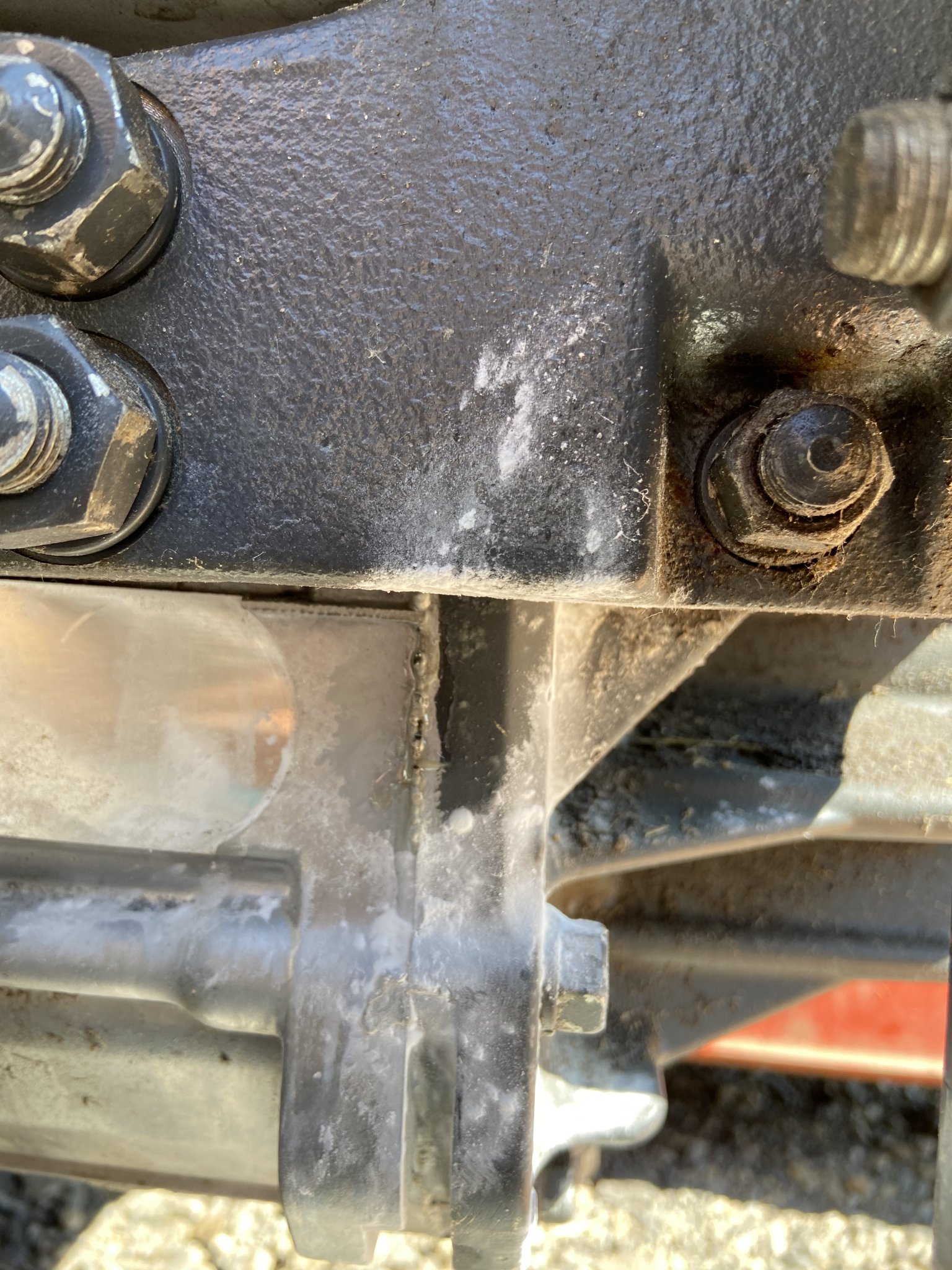

I have a 2012 bx25 that has started leaking under the rear axle. If the hydrostatic fluid is full it will seem to constantly drip. I can not seem to find it
anyone have any ideas?
the vent is ok (not leaking)
Looks like maybe from somewhere about the power beyond block. The picture is the oil from just pulling the tractor out of the shed.

Ckean/degrease. Top off and run (do not drive, just run the FEL or if you must just move it back and forth a few feet) a bit then blow baby powder on the area. The highest point the powder sticks is the leak

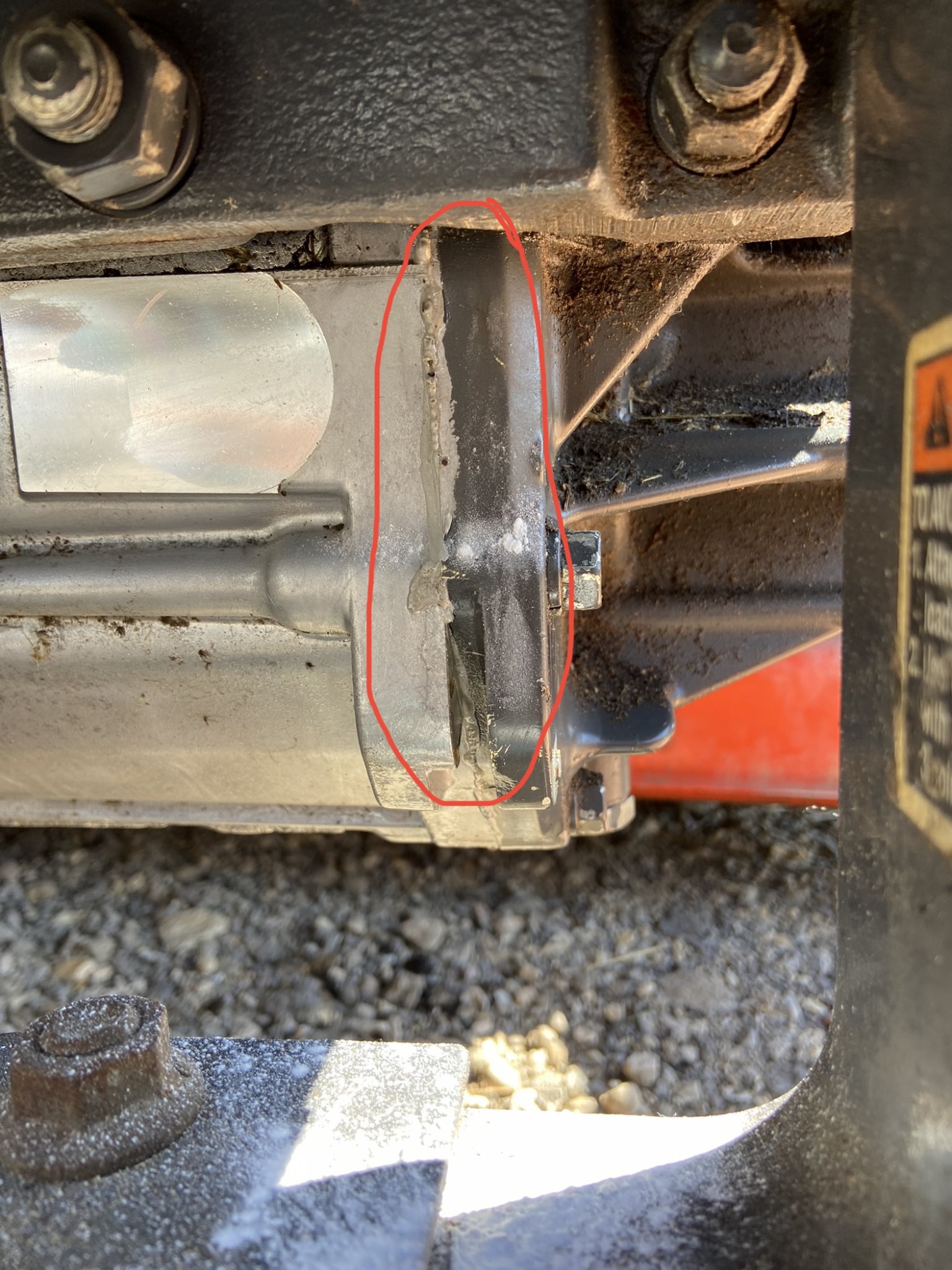

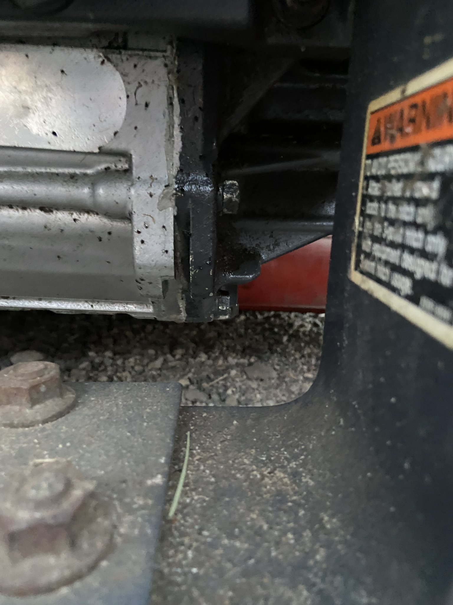

Everything is removed. Deck, FEL, and backhoe. I will try clean, no moving, and baby powder in the am.
it looks like it is coming down from above the power beyond or the hydraulic filter.
