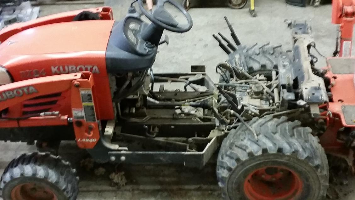

I pulled out the fuel tank today. What a half of a pain in the A$$ that was. The other half will be tomorrow putting it back in.
First thing I did was unhook the fuel line at the filter to drain it and just got drops. That's not good. I then pressurized the tank no luck, I can see the tank swell but it wouldn't push out the blockage. When I got the tank out I put the air gun to the outlet on the tank and cleared the blockage. I drained three gallons of fuel through a filter through that outlet and caught nothing. The last half gallon or so I sloshed around and dumped. Used two more quarts for two more sloshes and dumps and never saw any crud. Tomorrow before I put it back together I'm going to call the dealer and price a new tank.

Not sure I want to do this again. So we'll see what a new tank costs.
So do you guys have any sure fire ways to clean out a fuel tank?

Newlyme Not sure I want to do this again. So we'll see what a new tank costs.
This probably does not apply to your situation, but I've cleaned out fuel tanks by putting a quart of 3/4" gravel in them and attach with bungees to the rear wheel on a lawn mower and then mow the lawn. It SURE loosens rust!
Or put it in a cement mixer and agitate the rocks!
Maybe you have something GROWING in there and need an algicide, like Bio Kleen by Power Service.

I hope you don't have to do what I did!
I already did that to my tractor once. I had to replace the HSD fan, and that looks to be just about the same amount of work. Did you try to blow out the blockage before you pulled the tank? I wonder if that would have broke up the blockage and let it drain out the hose.
No didn't try to blow the blockage back in first. Once I found the problem I knew a good cleaning of the tank was in order so it had to come off anyway.
It's funny about the HST fan. I was almost wishing it was broken so I could fix it to! "Almost", being the key word. :)
I did give the HST a good cleaning though. That mud gets in everywhere.
