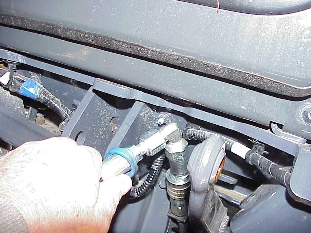

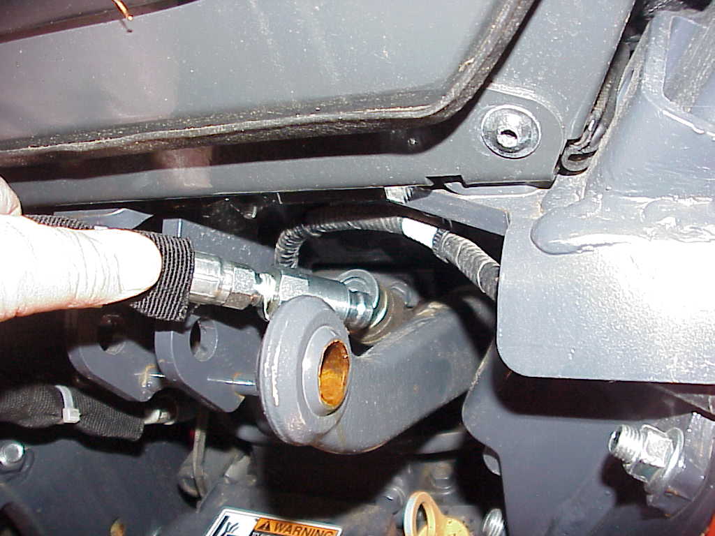

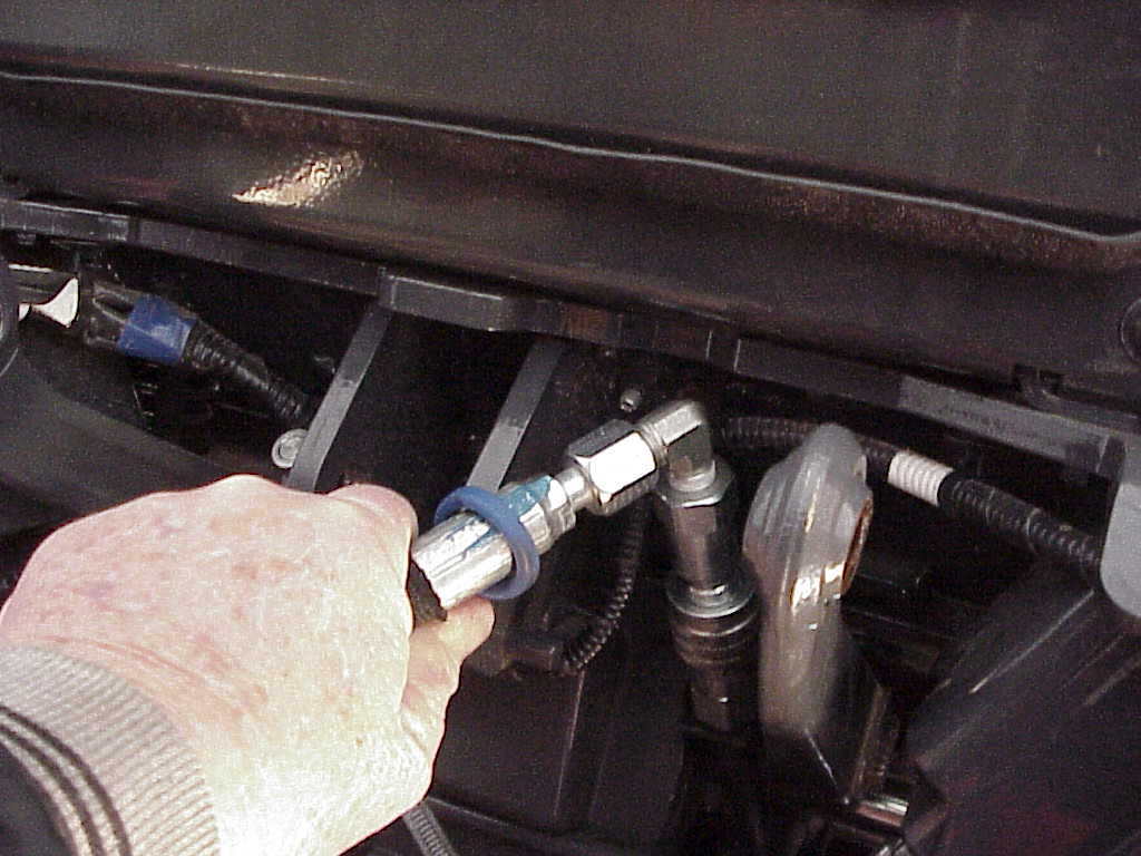

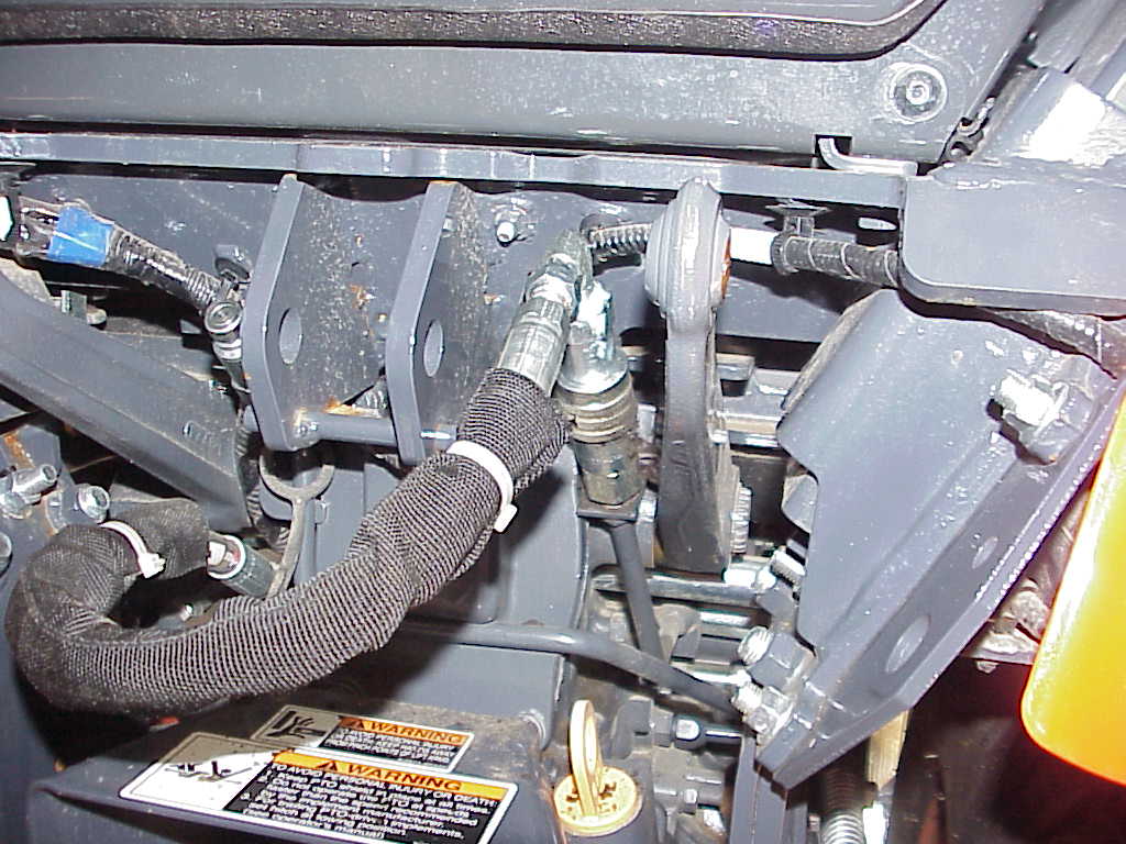

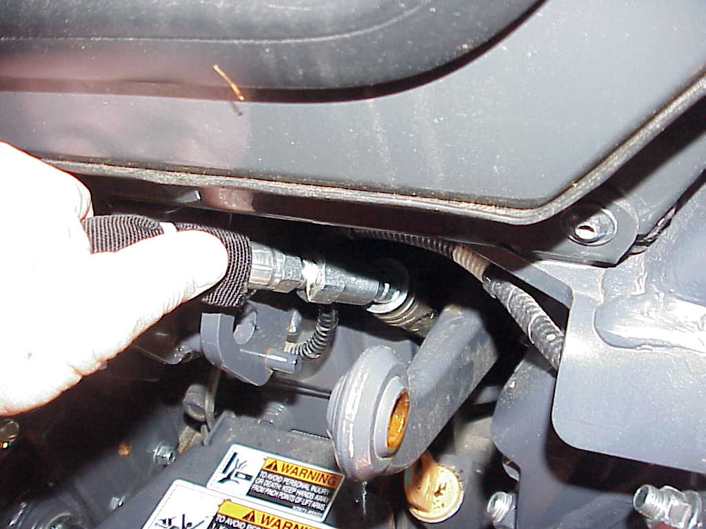

Do you have a BX23S with the Curtis Deluxe cab? Today I removed my backhoe in preparation for the installation of the weight box for the winter. Everything went well until it came time to put the hose that comes off the left side of the tractor onto the female connection on the right-hand side of the tractor. I just couldn't plug it into the other half of the coupling. I then looked at the part that I took off of that fitting and noticed that it has a 90 degree fitting at the male coupling where it joins the hose. I tried it in the coupling and had no difficulty installing the male coupling into the female coupling. Upon very careful examination, I realized that the metal of the hose was hitting on the edge of the tractor cab. I dug around in my box of hydraulic fittings and found a suitable 90-degree fitting to remedy this issue. I would have thought that the dealer would have seen this as being an issue and resolved it prior to the delivery of the tractor with the cab. Does your tractor have this issue or did your dealer make the necessary modifications to the hose? I will post some pictures in the morning. It was cold, and I just left this to finish it in the morning when there is more light and it is warmer.

Got it fixed today, only took about 15 minutes or so. In the first two pictures, you can see how the hose and nipple want to go into the fitting, but the cab is in the way. In the next picture, this is the original factory hose in the fitting, so you can see how the factory plumbed it. The last picture shows the factory line with the added 90-degree fitting. The only way that you wouldn't need this, is if the factory realized this was a problem, and changed the angle that the hard piping is done to accommodate the cab. My tractor is a 2019 model that was sold in April 2020. I did examine the steel line and bracket for the possibility that it had gotten damaged some time, but there was no evidence of that, and all the bends look proper and so no cracking of the paint or having ever been hit.
