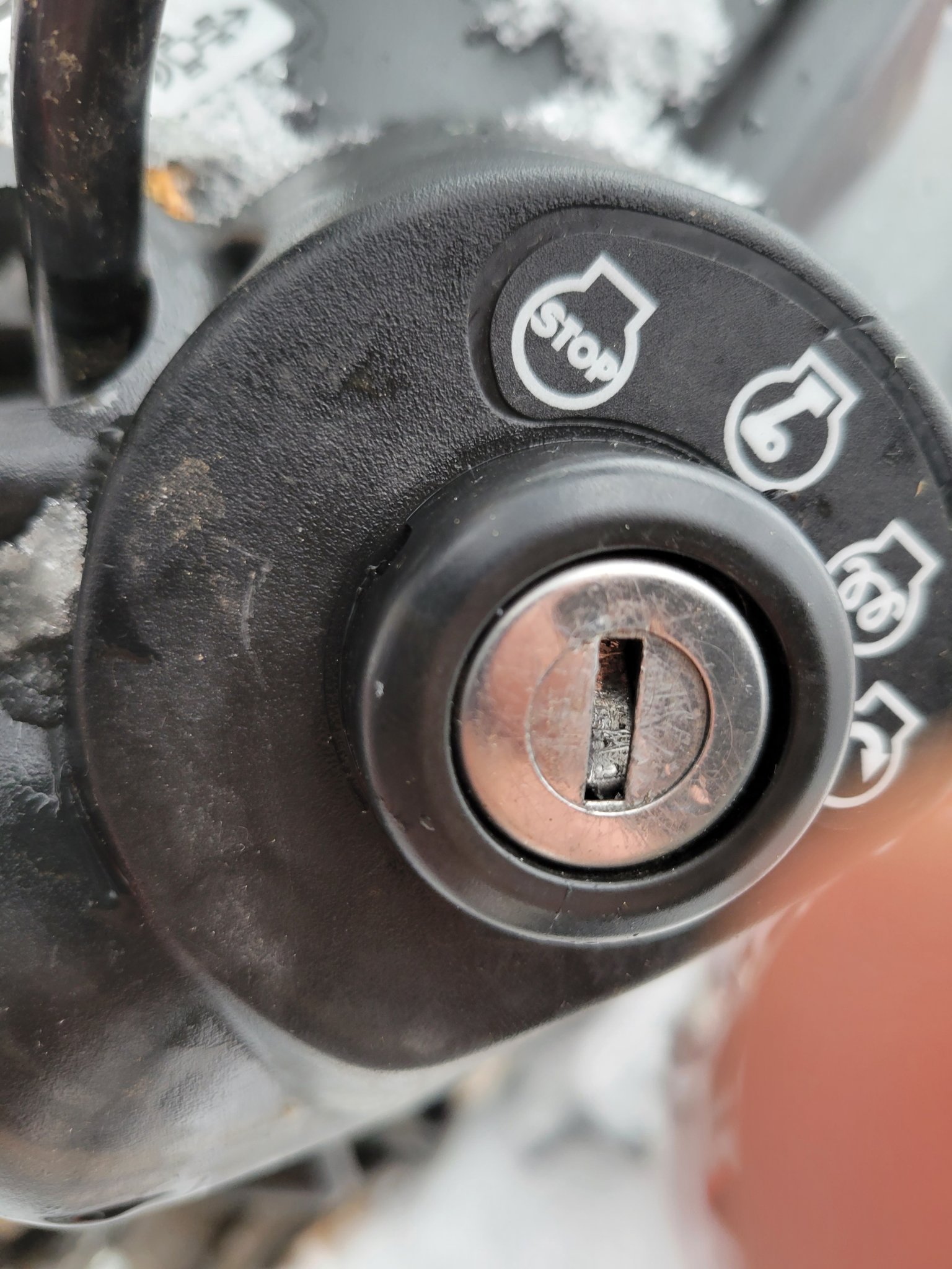

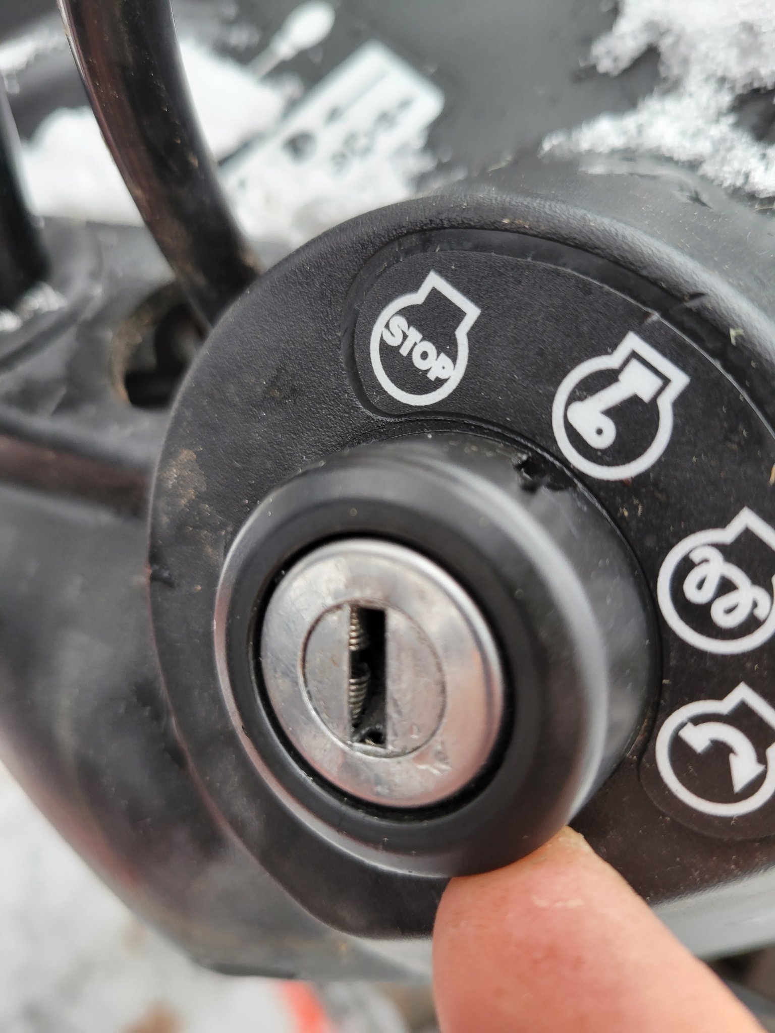

This is probably the silliest thing I have ever had brick a piece of machinery, but the tiny metal cover in the ignition bent when I tried to start my tractor this morning. I can't get it out, cant get a key in to start it, and the part seems to be built into the dash cover, which seems to require pulling the steering wheel to remove or replace. So I'm sitting here with a foot of snow on the driveway and a tiny piece of metal keeping my tractor a quarter mile back in the woods. Has anyone had this happen before and have an idea on how to fix it?
33,389
8,700
Your going to have to replace the switch, the door simply failed.
Now to get it going Put a screwdriver in the slot and pry/ and rip the top cover off.
That will let you be able to insert the key and get it running.
You can also just use a grinder and grind the thin nickel metal face off the switch.
12,918
5,646
YIKES.... $111 Canucks to buy it !!! Just checked... for $10 there's a cover for it though......
If you have some dental picks ( Princess Auto..sells them.) , you can extracate (fancy word for remove...) the 'door flap' and springs. Even an O-ring removing tool should work. Trick is to move the metal with one tool, then snag it with a 2nd tool.

If you get the door out of there and the switch operates normally, I’d go with the cover, or anything else I could find to keep the weather out.
Gnosis
BX23s
Feb 2, 2023
Thanks everyone. I wanted to see if there was a polite solution before I went in with more force. Ended up just popping the front off and pulling the metal bit and springs out. Works just fine now. For a tractor with 60 hours on it, I have to say I'm pretty concerned about all the little parts that break off or stop working. I love the little thing, but I'm not hopeful about longevity.

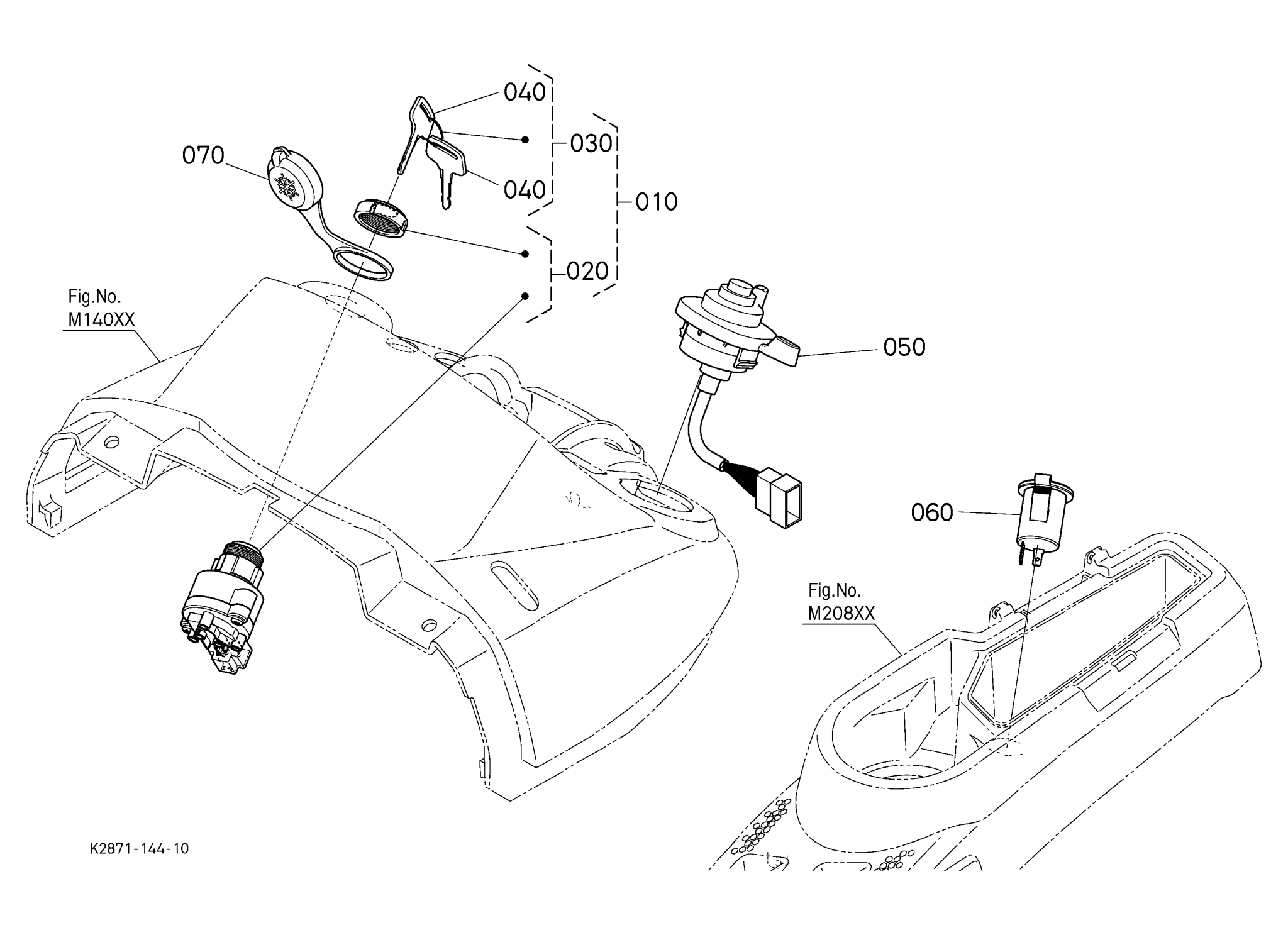

12,918
5,646
In my post #5, the dwg shows the cover number 070, it's about $10 CDN.
it's actually on the cdn parts finder page....
part number....K287196262 called... assy, cover price ....$10.31
Looks like you remove the mtg nut,add the cover,put mtg nut back on.

hmm.. at just 60 hours, how old is it ? Might be under warranty ? If not ,talk nice to the dealer about the 'rubber cover' K287196262 . He'll probably give you one for free.

yeesh, I finally looked that the pictures...
sigh, yes, it should have been covered up
'water' doesn't generally do damage, until it FREEZES....
I suspect 'wet snow came down, layered up, then it got cold and froze .....bad news....
best chalked up to a 'learning experience'....

My bet would be the lock is frozen and full of ice based on what I see in your photos.
Try a blow drier and some de-icer.
New to Canada?
Not new to Canada, but I'm new to machinery that falls apart under light use.
The PN# is K2871-96262
