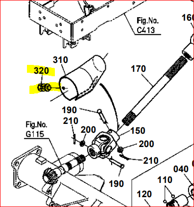

After 560+ hrs over 3 years my BX23s started to make a 'funny' noise up front. A kindy light, scrapey noise but not 'tinny'.
Turns out the 'flanged screw' that hold the U-joint cover at the front axle was missing ! Found a short Metric bolt ,lock washer and snugged it up, problem solved.
All with BX series( I think they'll be the same ?),might want to check that bolt, 'snug' it a bit,NOT to much though!!

this the bolt? I may need to check mine!
