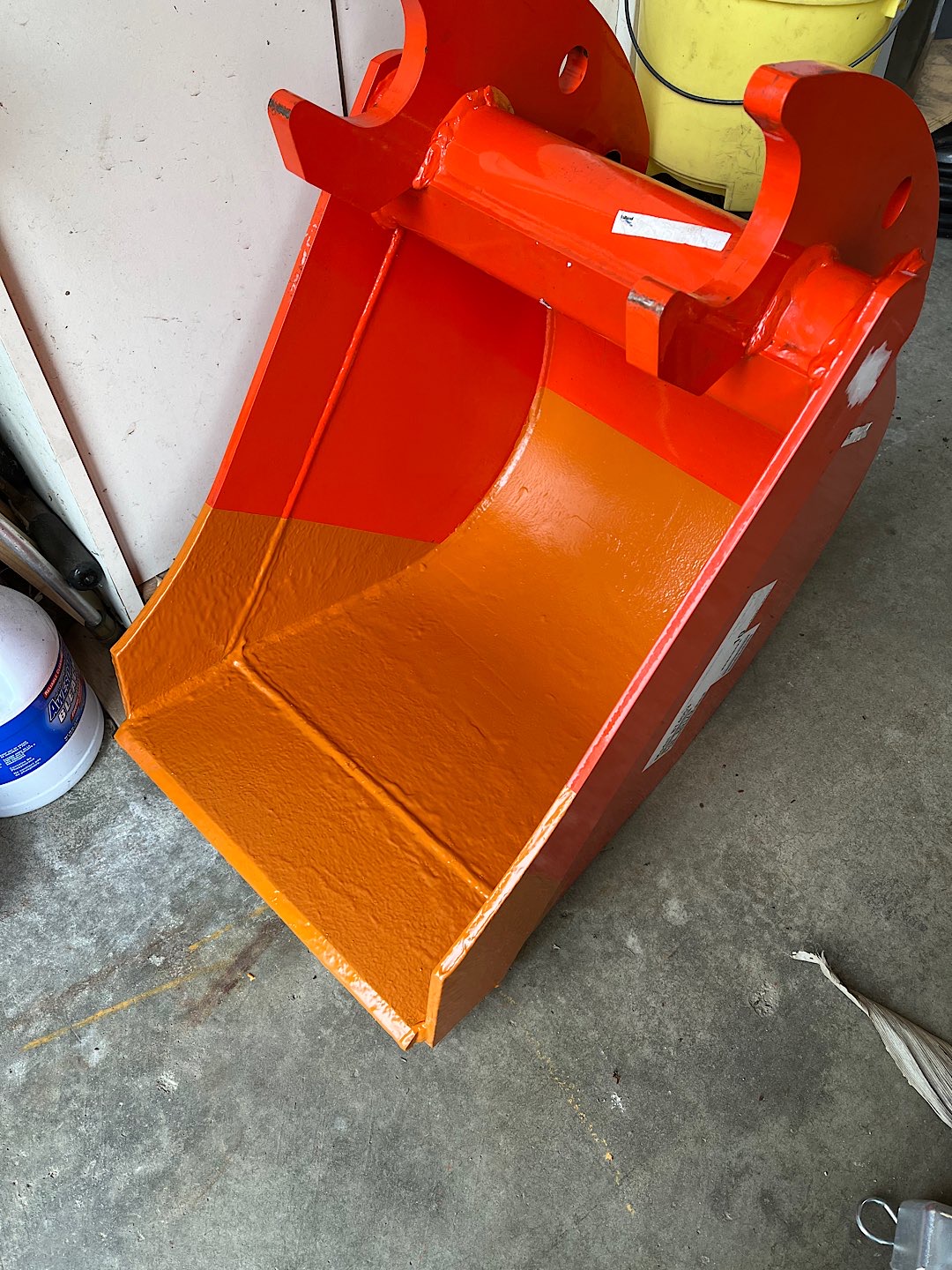

I went through my dealer for a 16” and it took a good while to get. Then dropped at local fab shop and had the teeth cut off. It’s nice to have both toothed and flat face available. I have the QA. I’ve heard of others that find buckets and order the “ears” to make them work.
This company might be able to help you with that.
https://poconometalcraft.com/collections/kubota
This place maybe worth a call too. I heard at one time they manufactured Kubota BH buckets for Kubota (info I have not verified).
https://werk-brau.com/about-us/
I’m using my FF for first time this week to excavate for a flagstone walkway.
Good luck.

The 16" bucket does not have bolt on teeth?

That's a 'trenching' bucket, no teeth needed
WRONG!
Check out Kubota K7873.......It is a 16" Kubota trenching bucket (by Werk Brau for Kubota), and has 3 teeth.

hmm, picture in #3 post, NO mfr or part number, which I was referring to, the bucket does NOT have holes for mounting teeth. Around here ,we call them 'trenching' buckets ( leaves smooth tench).

Since the new bucket was specifically "modified" to have the teeth removed, it might be reasonable to conclude that the "fab shop" welded the no longer needed teeth holes closed.

OP mentions having shop modification to remove teeth. My question was simply did it have bolt on teeth, which seems if it did why have shop do further modification? Just unbolt the teeth and you now have your grading bucket?

Yes, the bucket came with 3 teeth. Kubota does not sell a FF bucket (I’m told). I ordered it last June(ish) and it arrived in April.
Here’s cost and a before pic. The teeth will interchange with my 18” toothed bucket so I kept them. I ordered a 16” because it was cheaper and most footings (for residential work) here in MI are 16”x8”.

Kubota/Werk Brau buckets do not have bolt on teeth!
They have pin on teeth, and the root of the tooth is welded to the bucket.
Less expensive buckets often do have bolt on teeth.

Yes, saw that in the picture he provided
