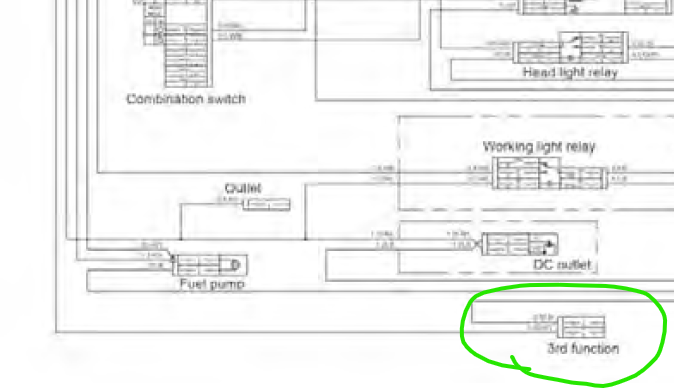

BX23S 3rd Function Connector
VonSquid
2020 BX23S
Dec 30, 2020
Seattle
I was looking at the BX23S electrical schematics recently... they show a 3rd Function connector (attached). Does anyone know if this connector is installed on every tractor, or only those with a factory installed 3rd Function Valve (if that's even a thing)? If the former, where is this connector physically located?

I was looking at the BX23S electrical schematics recently... they show a 3rd Function connector (attached). Does anyone know if this connector is installed on every tractor, or only those with a factory installed 3rd Function Valve (fi that's even a thing)? If the former, where is this connector physically located?
The connector is on all BX23s units and is located next to the loader control valve under the RH fender.
9,901
4,055
It's there, dang sight EASIER to see than to READ that wiring diagram !! Must be same copy I got, virtually USELESS....sigh.
Thanks whitetiger. Appreciate the prompt response.
Follow-up question: Do you know the part of the mating connector? As GreensvilleJay points out, the diagrams are very fuzzy and hard to read.
