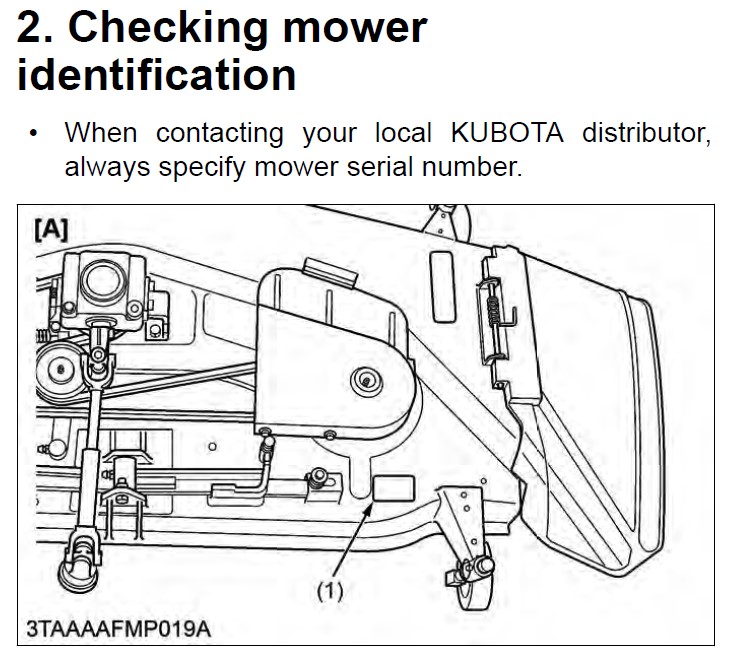

don't have one but think mower number -bx23 or similar should be on the tag ?
since you're in the USA, try to 'build a BX' and look at the deck options, should give you the deck models that'll fit.

See if they will send you a picture of the tag or type the # in a message reply.

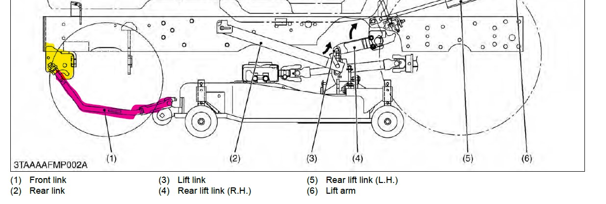

This image shows the front link (red) and bracket (yellow) that you MUST have to connect the mower.
All other linkage should be on the tractor. If not you're screwed and have to call the dealer. All of it should be readily available.
I did receive the front link. I will double check to see if my tractor has the front bracket, though. I have help to move the thing around today, so I’ll report back how it goes. Thanks for the heads up!
