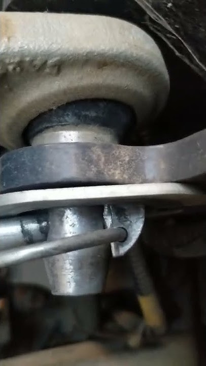

Here is a link to the video. You can here it pretty well I think....
Phone videos usually exaggerates sounds so it's hard to tell. I can hear what you're likely hearing but my BX is kind of loud sounding at times. It's 2020 with only 57 hours but if I held a phone to it it might sound the same way.
I would definitely change all fluids now though.. past due! or at least the filter is..

Ok, hydro service done with Sudt2, oem filter and cleaning strainer. There was a small amount of metal shavings in the strainer.
Here is a link to a video I took after service.
I don't hear much difference. It is not noticeable from the seat while operating with ear plugs in.
Should I worry?
10,016
6,814
Is the 3 point hitch all the way up to the top stop? If so lower it to bottom. Just checking to see if it’s going into relief. Can happen, and can cause a bunch of problems.
Still sounds sharp/high pitched, but I’ve never recorded mine like that.
I would use it and keep an eye on it, or more properly, an ear on it…..
