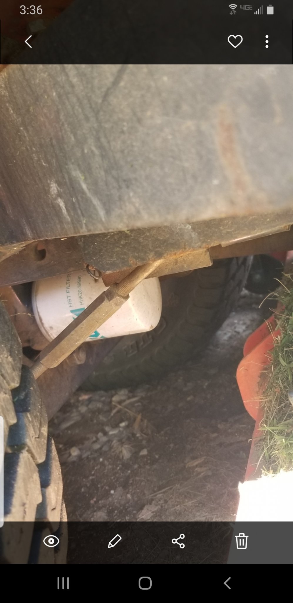

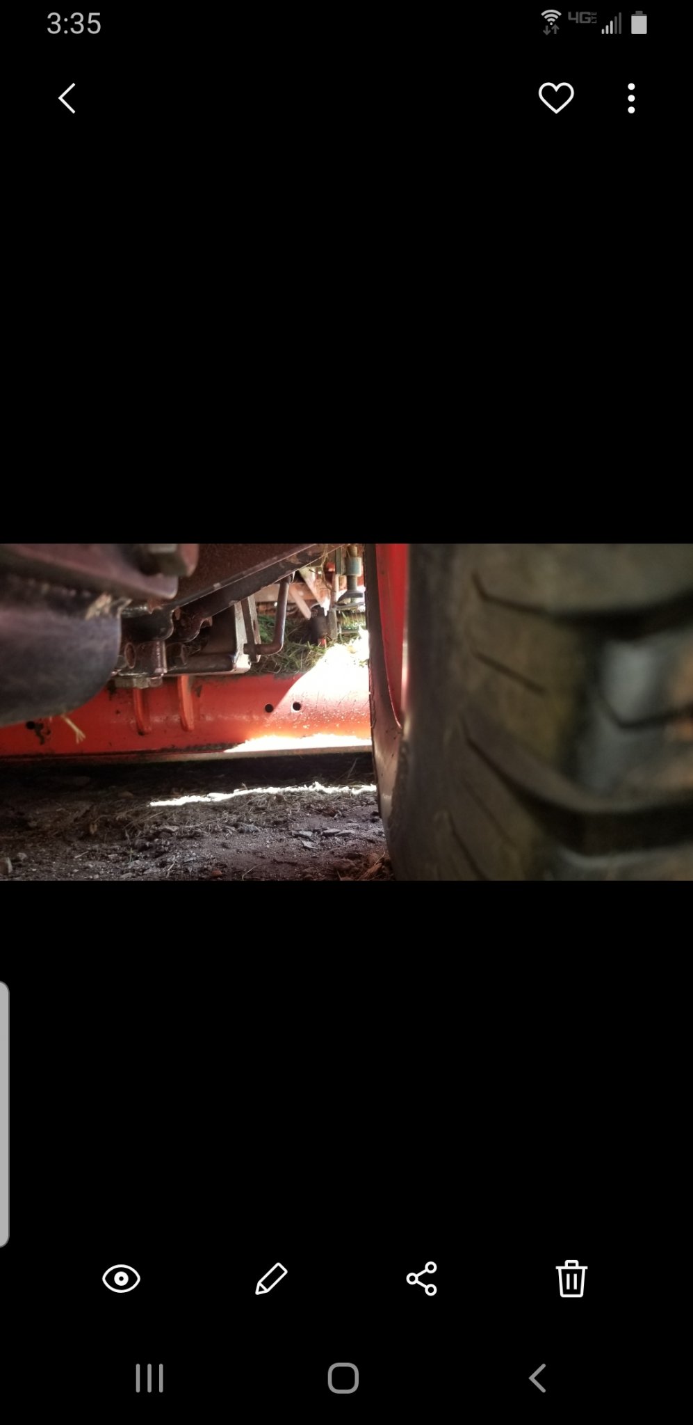

I bumped some stuff with the mower deck and the lift stopped working. Years ago, I broke a rod that runs from the rear of the tractor to a lever on the deck. However, this rod appears intact. I do not see any movement in the rod when I try to raise the deck. Any thoughts?

From your pics that isn't the lift rod. Stand behind the tractor and on the left side near the top of the left wheel, the rod and sliding mechanism are there . Make sure there still pinned to the upper 3 PTH arm that comes off the rockshaft. Like someone else mentioned if the 3 pth arms aren't lifting or going down , check to see if something has gotten bent or jammed up.

The nuts and collar are off the back of the lift rod. Anyone know the size of the nuts? I'll probably have to schlep over to the dealer.
