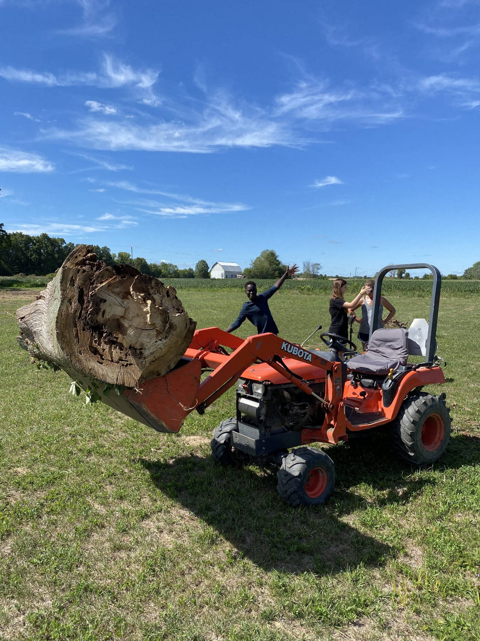

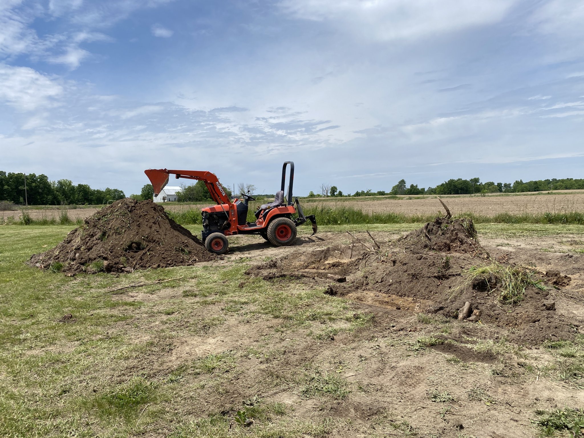

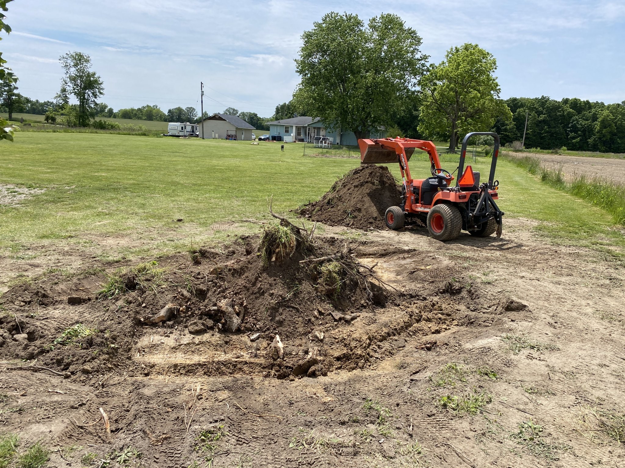

When I purchased my property about a year and half ago the previous owners had a tree that they had cut off about 10-15 ft up. I am assuming t was too big for them to actually cut down. There were cuts at the base, but none very deep. It had been sitting like that for a while because it had rotted enough that I was able to push it over with my BX2200.That left the stump. I used my ripper to tear up the roots around it and the FEL to dig down around it, but it is still not wanting to budge. Any ideas? Chain down around roots as far as I can and start pulling? I also have an Excursion I could use to try and pull it out. Just looking for ideas from people who have done this in the past.

Can you a pressure washer to it? If so, you would be amazed how it exposes the roots using a blaster tip. Afterwards, you could cut them, and you might be able to pop it out.

I do have a pressure washer I could attack it with. I was trying to come up with a way to expose the roots and stump more.

Pressure washer or compressed air from something like a tow behind jack hammer compressor. As mentioned exposing the roots does wonders. You'd be surprised how many get tucked up in there ha ha

Judging by the chunk in the bucket, that tree will have a very large tap root. Usually right in the center going down. Once you expose and cut the runners, it should wiggle out. Eventually. I’m betting you have to go 2-3’ deeper to get it wiggling.

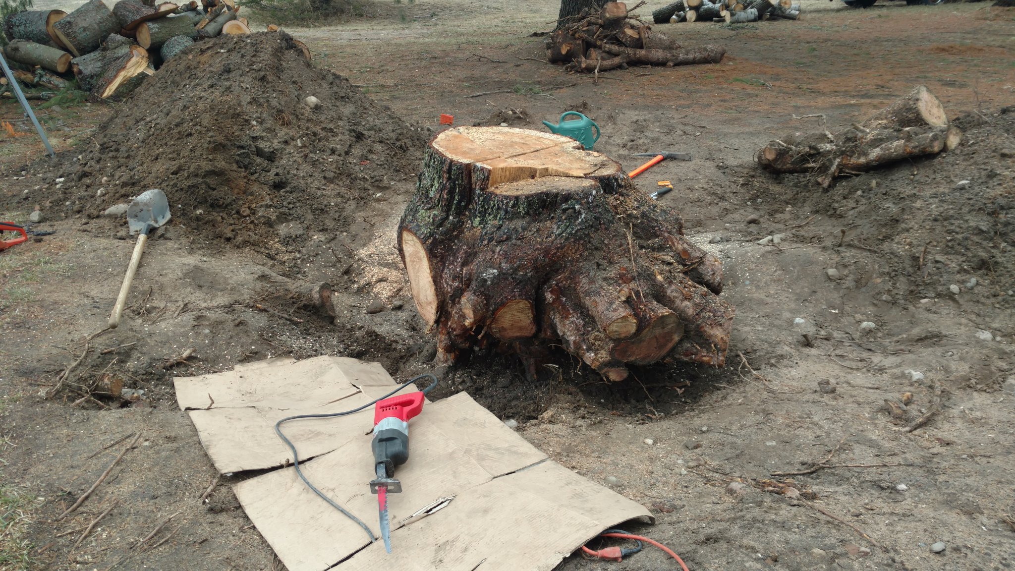

28" white pine cut green I hand dug out.
Carbide saw blade on sawzall was big help.
a old bar and chain was sacrificed for some of the bigger cutting.

I am thinking this is the route I will go if I can get down below ground level to cut it off. I have it dug down, but I need to get rid of all the dirt to expose the roots. Hoping the pressure washer idea will work.
