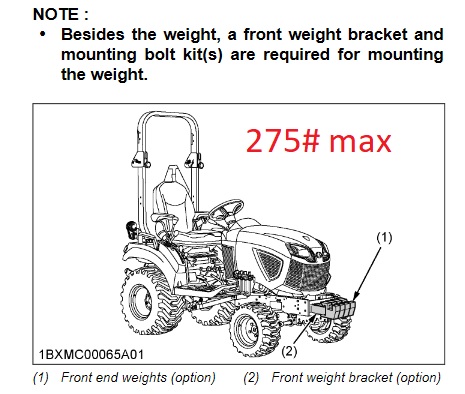

Max weight is #275 and must use the optional front weight bracket.
This assumes no other hardware on front of tractor such as front mount for snow blower.
Often called Suitcase weights.

I thought if I put the weight on the wheels it would be out of the way for other implements. Wouldn’t the front weight bracket interfere with the loader?
