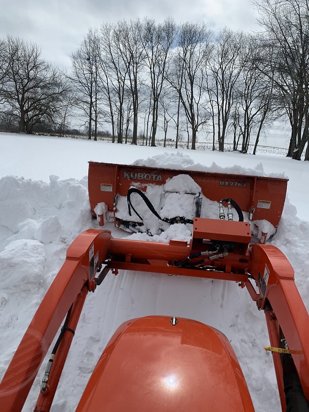

The 2767 does give you the ability to push the piles up high compared to the 2763. Good luck.
Hope this helps.
