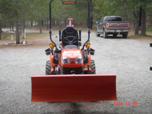

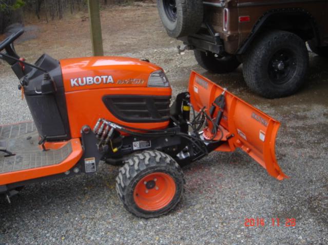

I'm thinking of putting a snow blade on my BX2370 but only if I can get one that has both Hydraulic lift and angle functions. The one from Kubota states it's only Hydraulic lift and manual angle. I did see one from Johnny Plow that does both. Any thoughts or other suggestions?
Thanks,
Glenn
heres what the hydraulic side to side, power lift, with the quick disconnect shoe looks like. I have seen two on the local Craigslist for $1,100. and $1,200 complete

What's funny about that, is its stamped " made in Canada" right on the blade assy. I finally got a chance to use mine today. We got about 8" yesterday morning and the night before. I was amazed how much this little tractor would push in 4wd high! I had snow 3' deep out front, and got it pushed back in the trees as far as possible. Gotta watch the low branches as the ROPS would hit them and dump snow down my neck.
