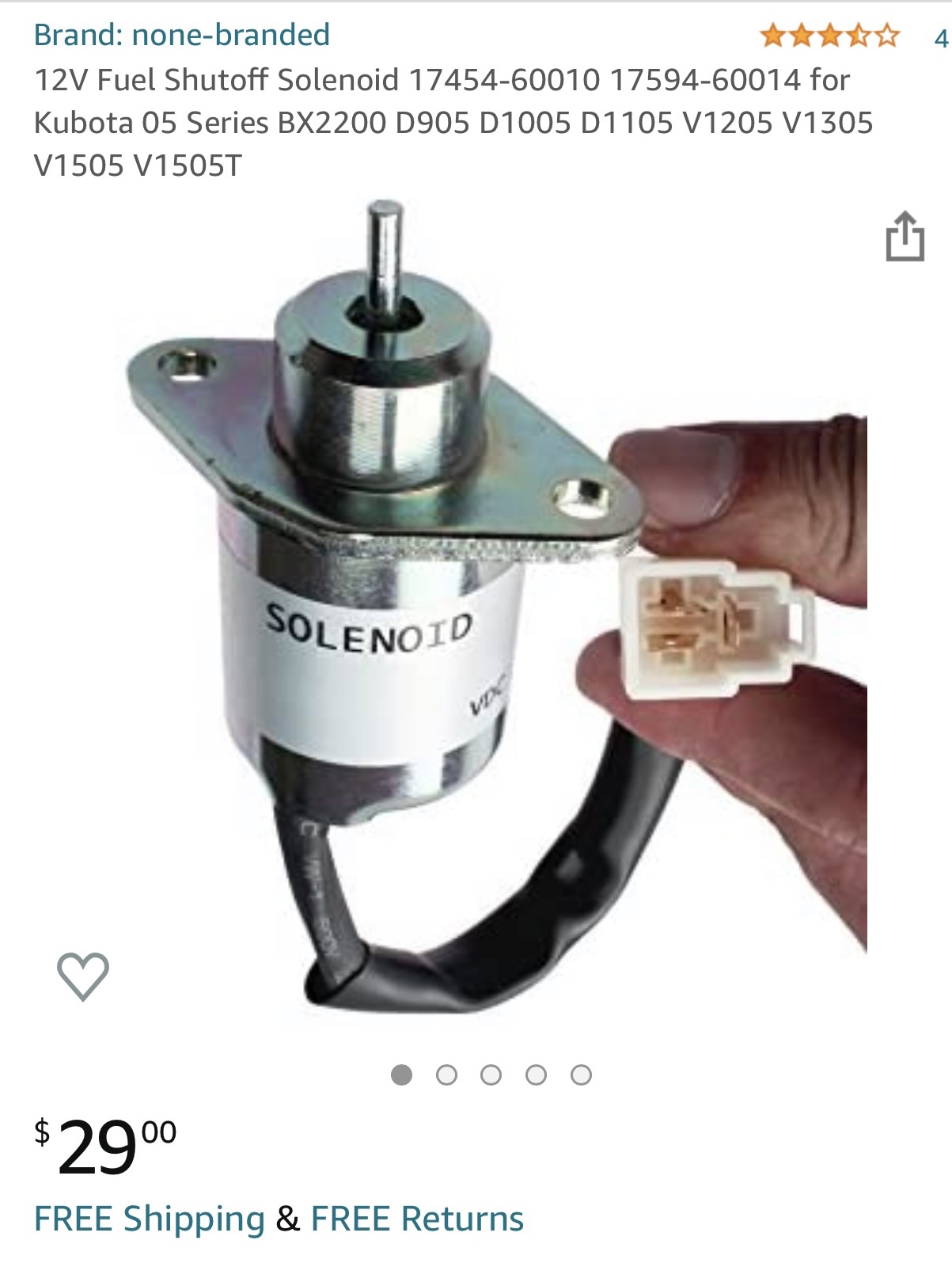

Fuel cutoff solenoid I would bet.
I had the exact same issue with my BX2200 a couple years ago. Bought an aftermarket solenoid for around $25 off Amazon or eBay (forget which) which was 25% of Kubota price and that included delivery.
Symptom was engine would start but immediately quit when the key was released back to the run position.

As Henro would tell you, the solenoid has two internal coils (that is why there are 3 terminals in connector in picture he posted) fed by two different circuits.
One circuit starts the engine and the second circuit keeps the engine running.
The test procedure I have posted, the part with the red box around it, tests the run portion of the solenoid.

The solenoid coil is on the side of the injector pump. The injector pump is on the side of the engine. I forget which side but it should be easily found if you look. The solenoid is held in place by two screws. Easy to change it.
