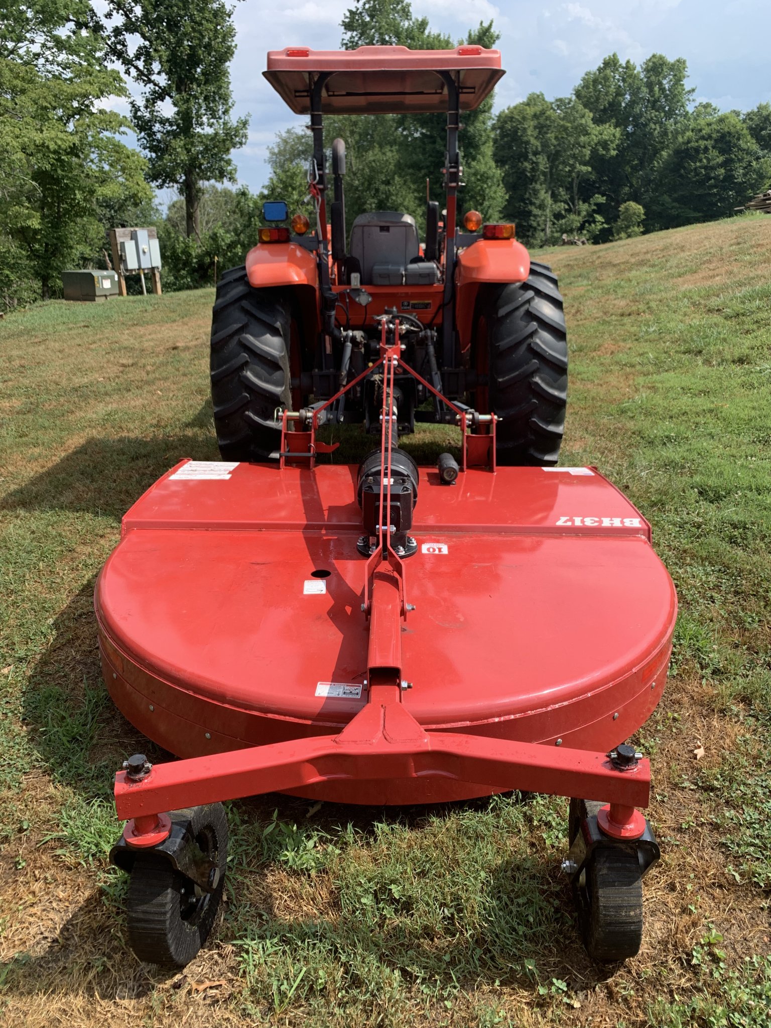

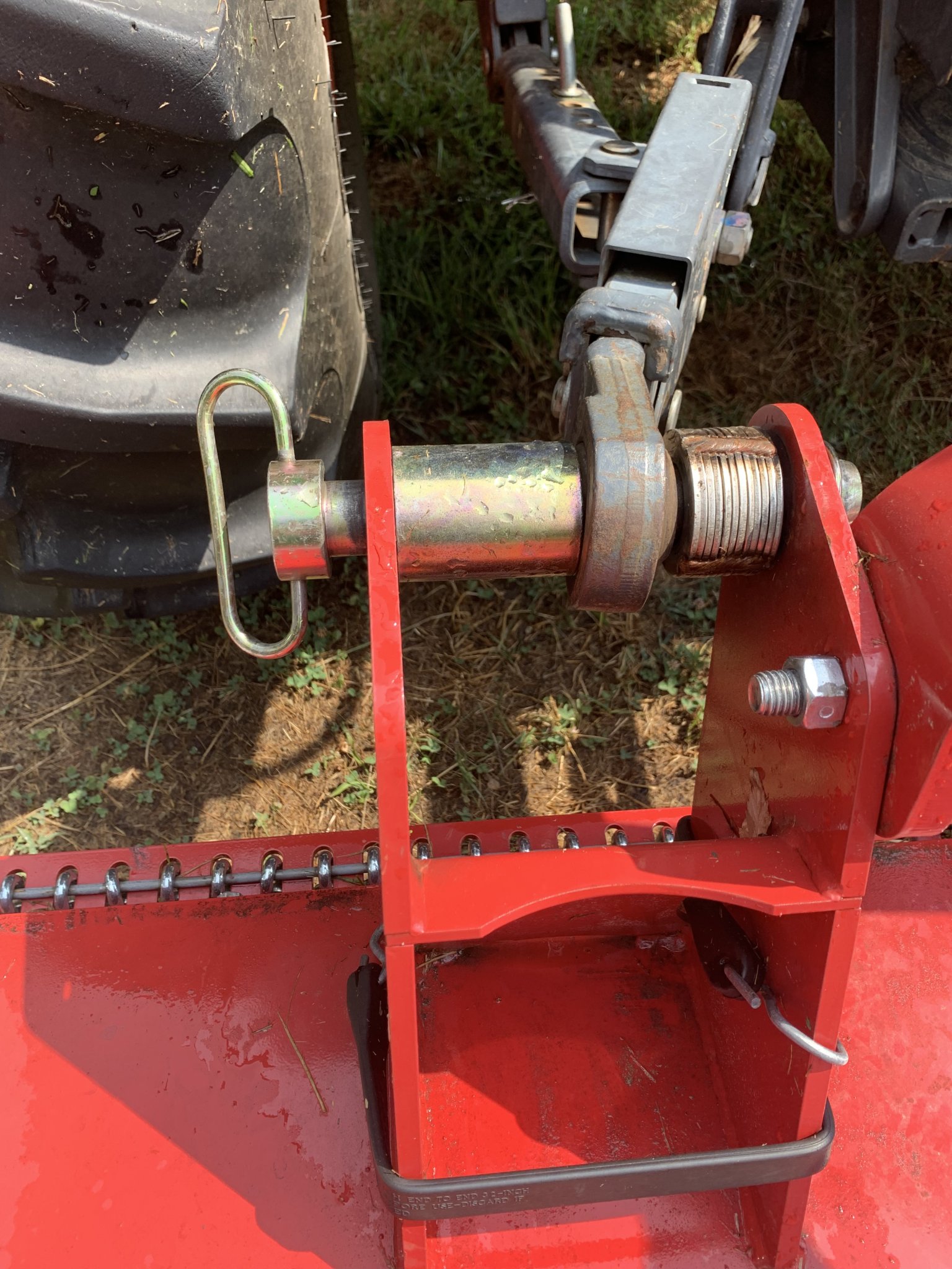

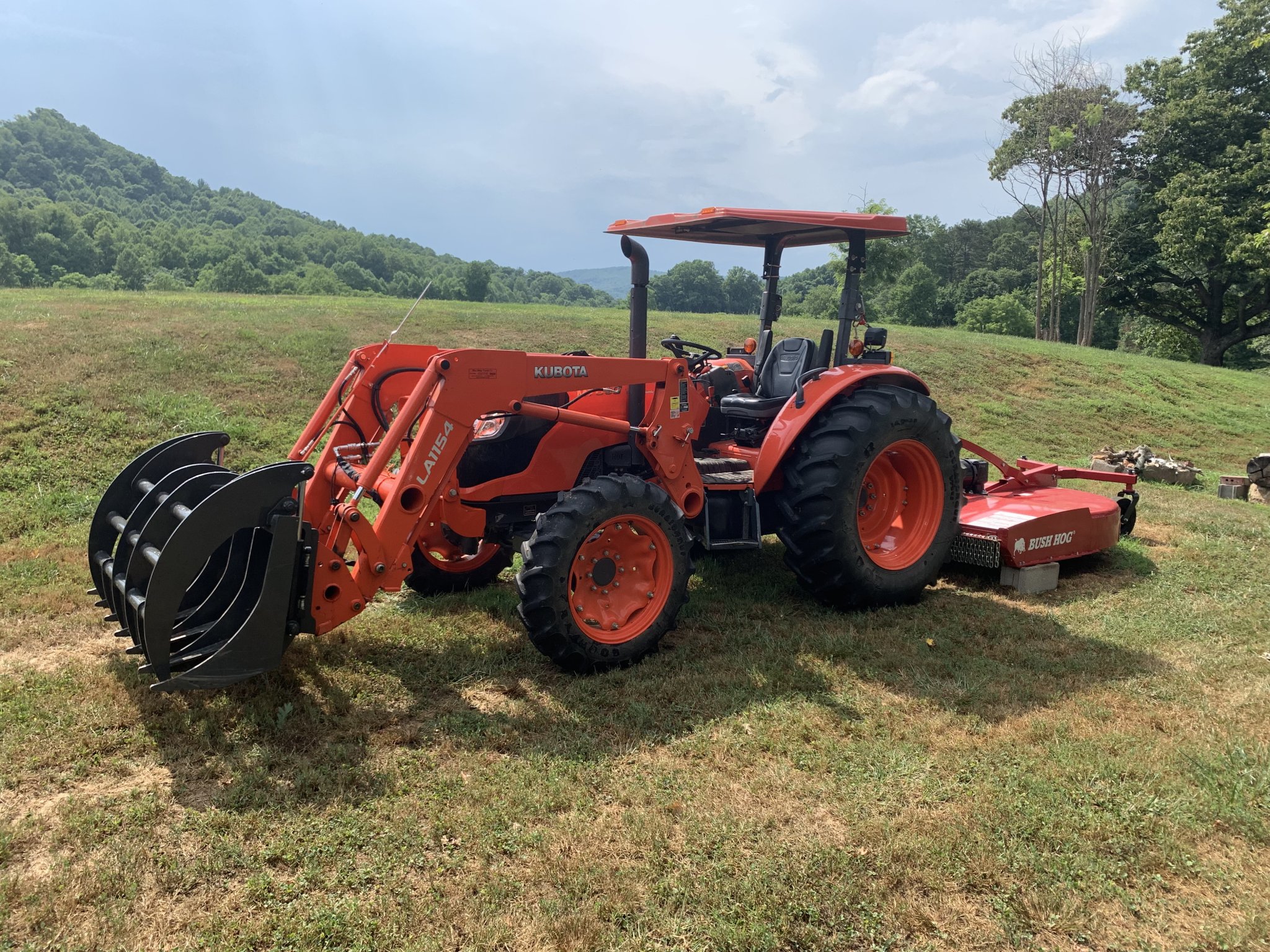

Update: I went with the BH317, dual tail wheel. Very happy with the decision. Tractor holds it well. Grapple on front of tractor is plenty of ballast. Width covers tire tracks. Easily knocks back heavy brush around my fields and nicely mulches grass. Only minor complaint, nuisance, had to fabricate additional bushings for the lower lift arms.

I’d like to see what you came up with.

That's an impressive rotary cutter. The owner's manual for the M7060/M6060 lists 1,200lb as being the max weight for a rotary cutter on the 3-point, 1,760lb for a flail mower which would sit closer to the tractor. I don't know how Kubota arrives at these numbers, but a big, heavy rotary cutter bouncing around on the three point wouldn't be good. I mostly only raise the cutter of the tail wheels when getting on/off the trailer which is a slow speed maneuver.
I run a Land Pride RCR1884 but it's a medium duty model weighing only 850lb or so. I don't get into anything that requires more than the 1884 offers so it's a good fit for me. I do have a much bigger and heavier folding cutter that's built like a tank, but it pulls on the draw bar of course.

I like your welded washer spacers too ... that's clever! (y)
