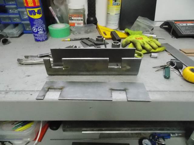

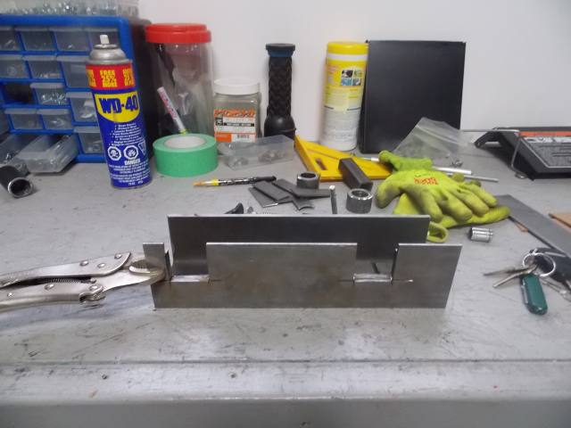

Hi guys, so I've decided to fabricate my own "quick coupler" which by the time I had bought the metal for it I found out about the "B1658" unit that you can buy for about $350.00 plus taxes here in Canada, but since I'd already plan my own and spent about $180 in metal I when ahead with my project :) Now the "quick coupler" is finish but since I design it using Sketchup prior to the built, I’ve decided to include a tutorial on how I did it. I'll be uploading the steps of the tutorial and some pictures I took during the build. I should mention now that my original idea came after watching “TooManyGT” youtube channel and seeing his homemade quick attach so shot out to him. I would also like to mention that all I use to build this was a 4½” grinder and a 120V small welder.
Here's Step 1 to 3 of the tutorial in pdf format and I’m posting 3 pics for step # 2 and 3 pics for step # 3.

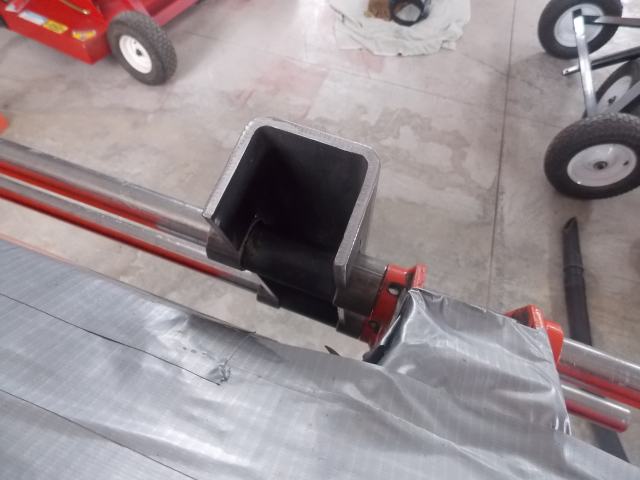

Here's some pics of step # 3, I will post more steps i did in the next few days :)
Now for some of you that rather follow all of this in video here the link of the first video of about 9 or 10 I have on the whole build, and I'm not done uploading them as I have modified a few things along the way :)
Any question or comments feel free to ask.

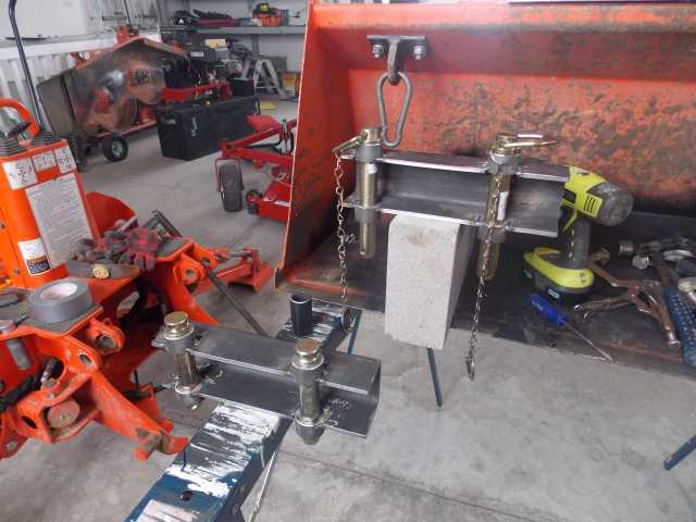

Notes about my built so far
So I should point out a few things I've done that are not showing in the tutorial and the pics, if you look at picture "Step-4 to 6 (5a) you see the holes I had drilled in order to tack weld the plate to main pcs, well I've decided to actually drill right through the main pcs and install small nut and bolt to secure the pcs together to give it more strength. That is something I do explain in my youtuve video since I forgot to take pics of that part so yes the videos show more as I did this over a couple of days and forgot to take more pics.

More Pictures for following steps
Yes I'll be putting a bar in between as you will see in the next few pictures :)
this set of pics show the sides already cover but it show the start of my lip at the top to grab bucket.
I have more information for the side stuff on my youtube channel and on this video link :
https://www.youtube.com/watch?v=J21zxMyLPDc
