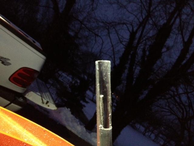

Most of the time, I don't feel the need for a bucket level indicator. There are two situations when it is very handy though. I made one from a piece of 1/4" rod that pokes up through a piece of plastic pipe fastened to the loader arm.
When I buried our 1,000 gallon propane tank, I was able to do it without excavating. The tank was placed at the base of a small steep bank near our house. I used the material from our underutilized sand volleyball court for a base and some of the fill. That was 75 tons of sand and about that much clean crushed limestone. The BLI made it easier to get just the sand and stone.
To complete the burial, I shaved topsoil from an area about 60' wide and took close to 18" off the one end and tapered to nothing on the other. With a new clean and sharp cutting edge, it went pretty well.
The second place it comes in handy is when I use the wings on the bucket for a homebrew snow pusher box. The wings stick out pretty far and if the bucket is just a little too far dumped, the ends of the wings drag and wear down. With the indicator, I can be getting the bucket set to be level to the paving before I even drop it.
