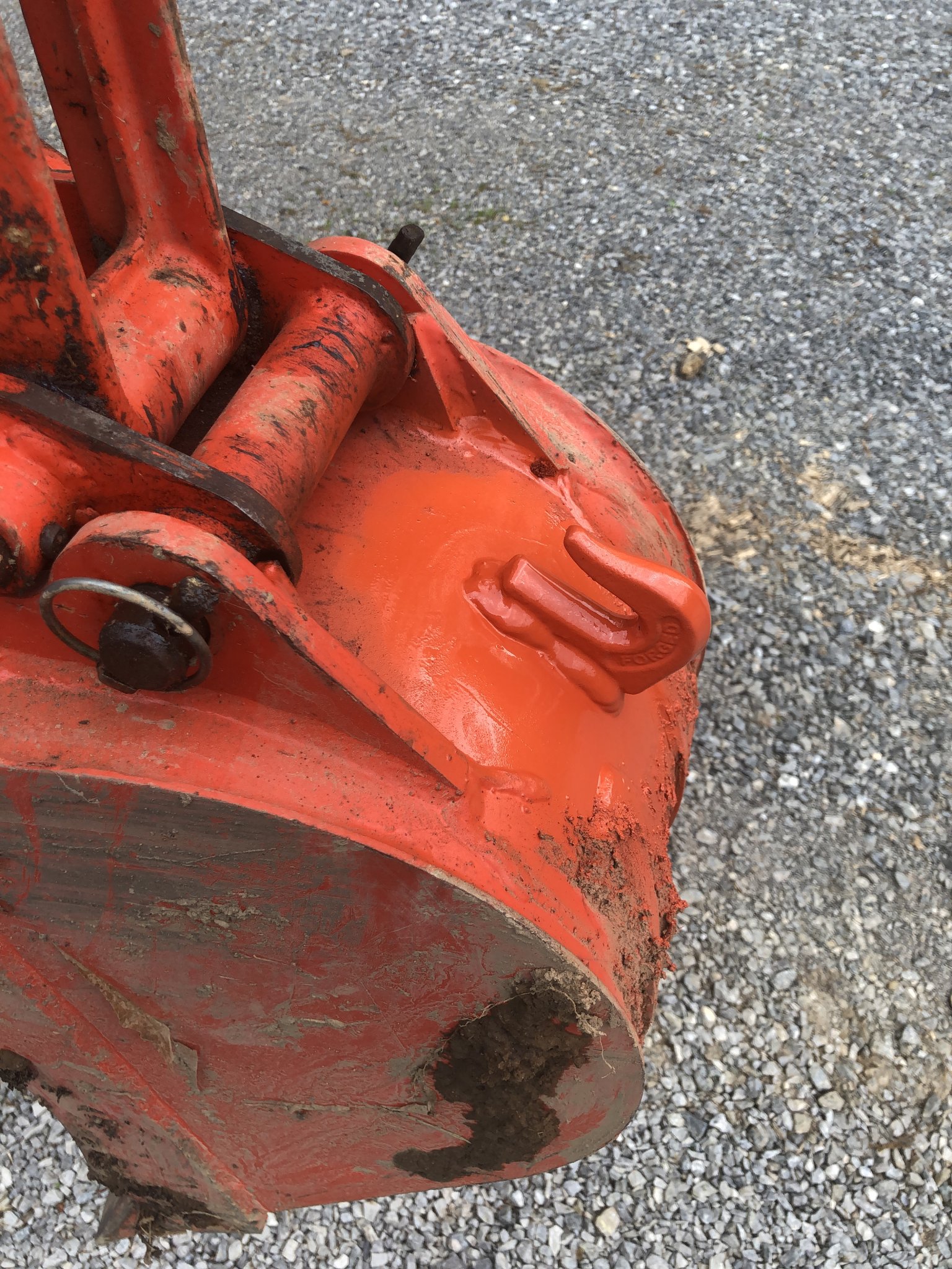

I tend to hook on the side of the bucket
Try not to eat hook when your chain slips

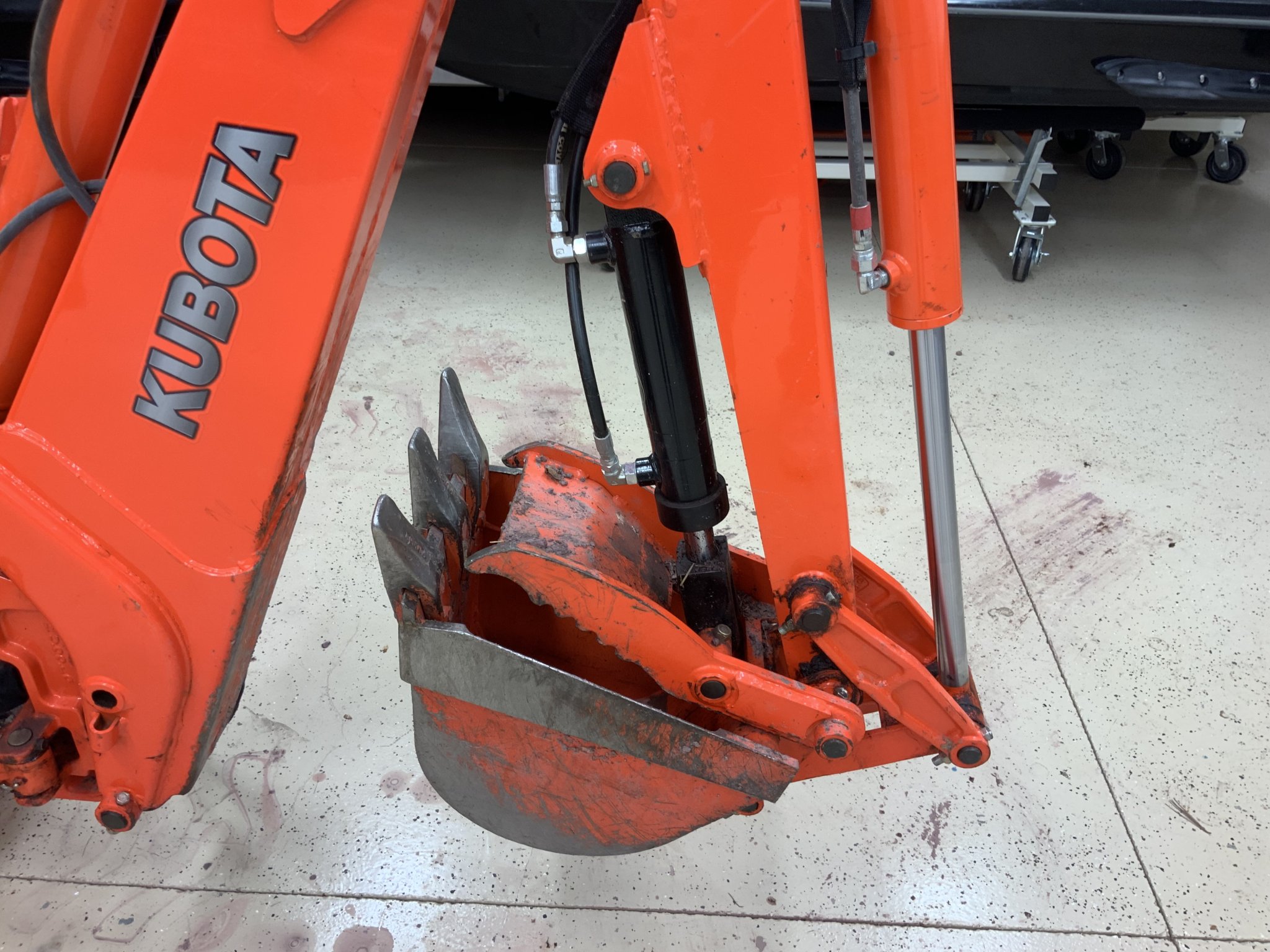

I find my hydraulic thumb is way more useful than trying to use chains on roots

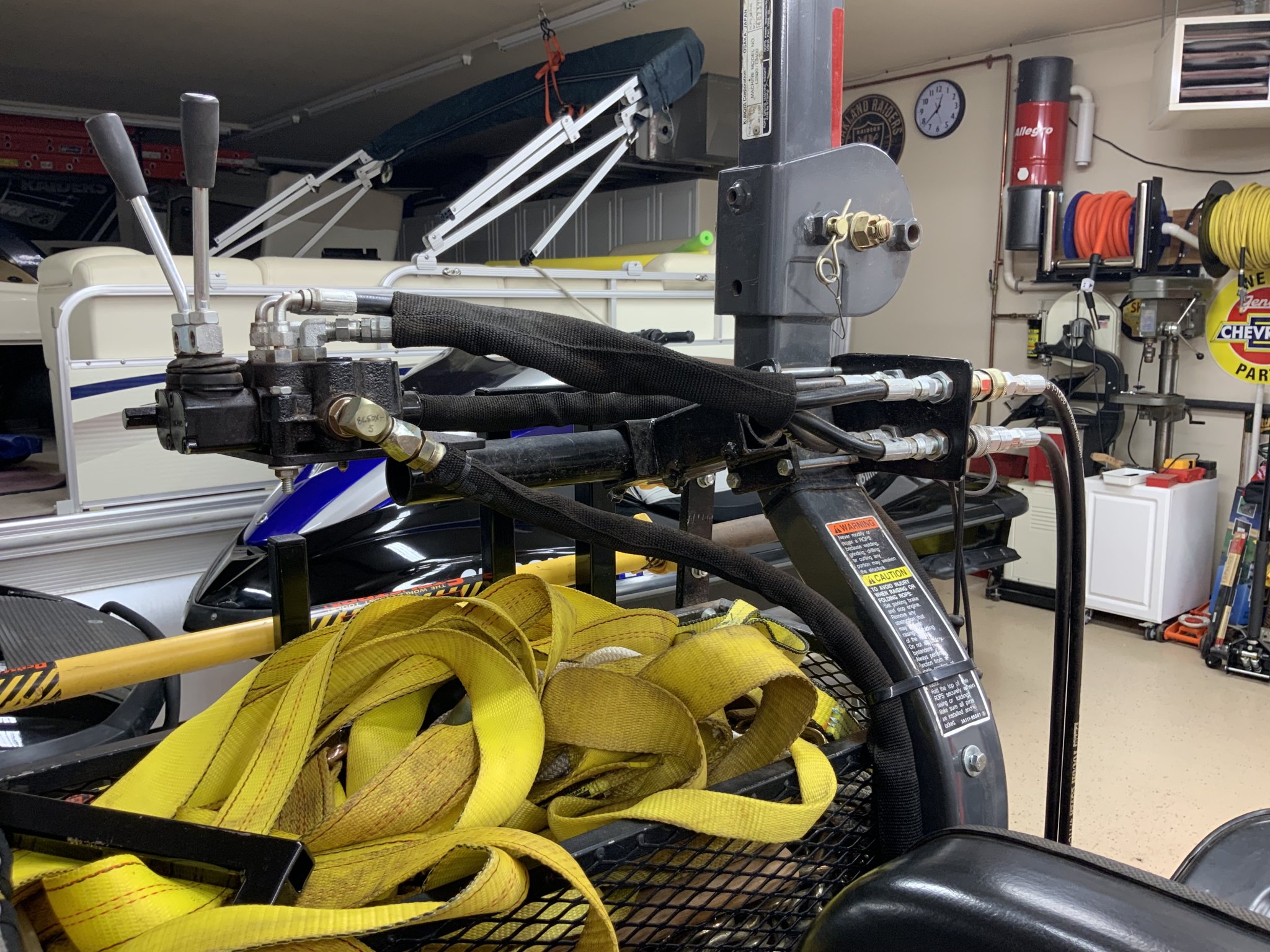

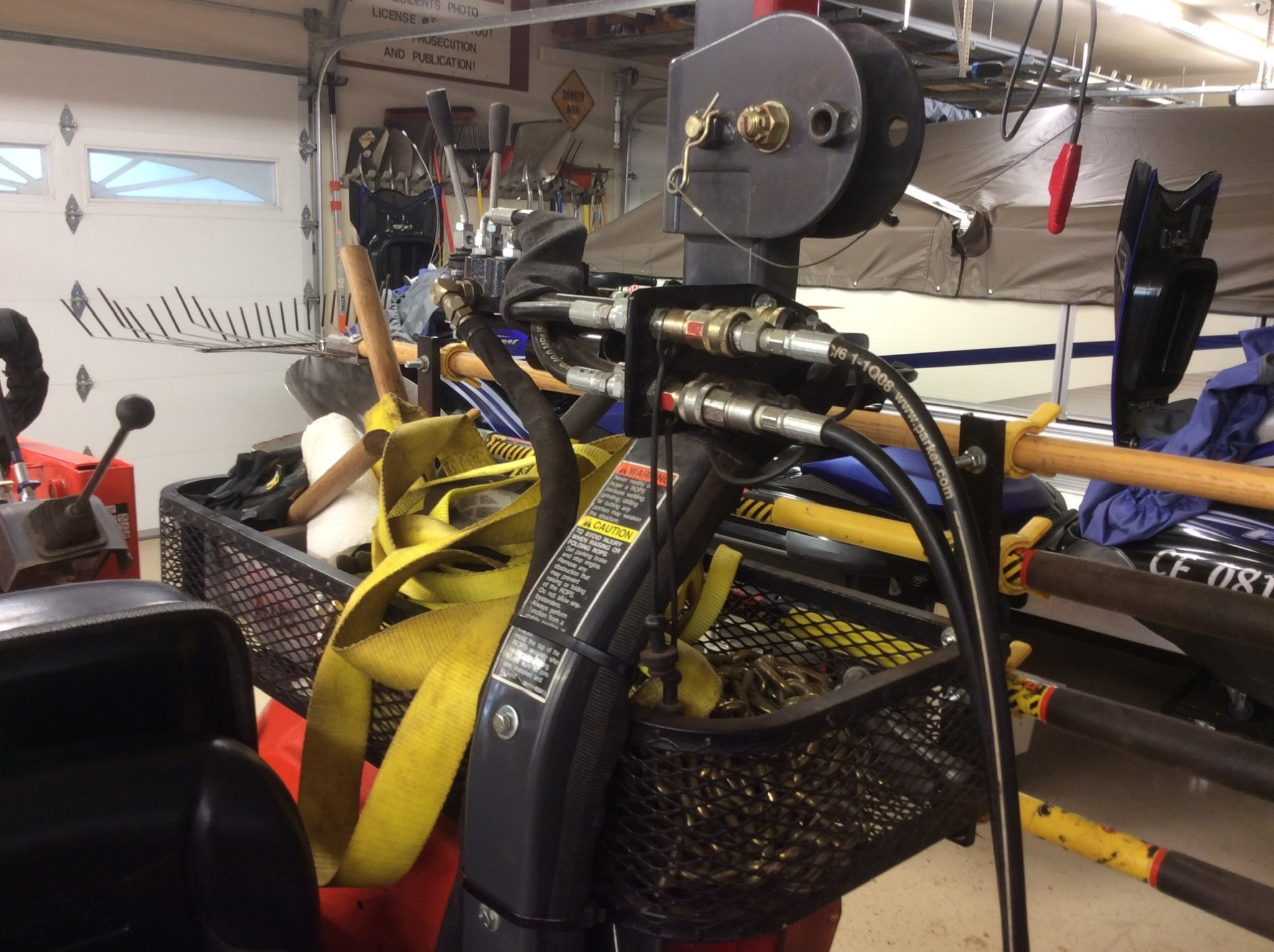

It is a fixed thumb that came with it…I figured out very fast that the hydraulic was the way to go So I removed the fixed part and added the ram. And no, the hanging hydraulic lines are not an issue. I was just careful to mount them so they wouldn’t pinch. Had it that way 10 years now and no issues.
Tarmy
L2800, BH76A, FEL,box scraper
Nov 17, 2009
364
198
Lake Almanor, Ca

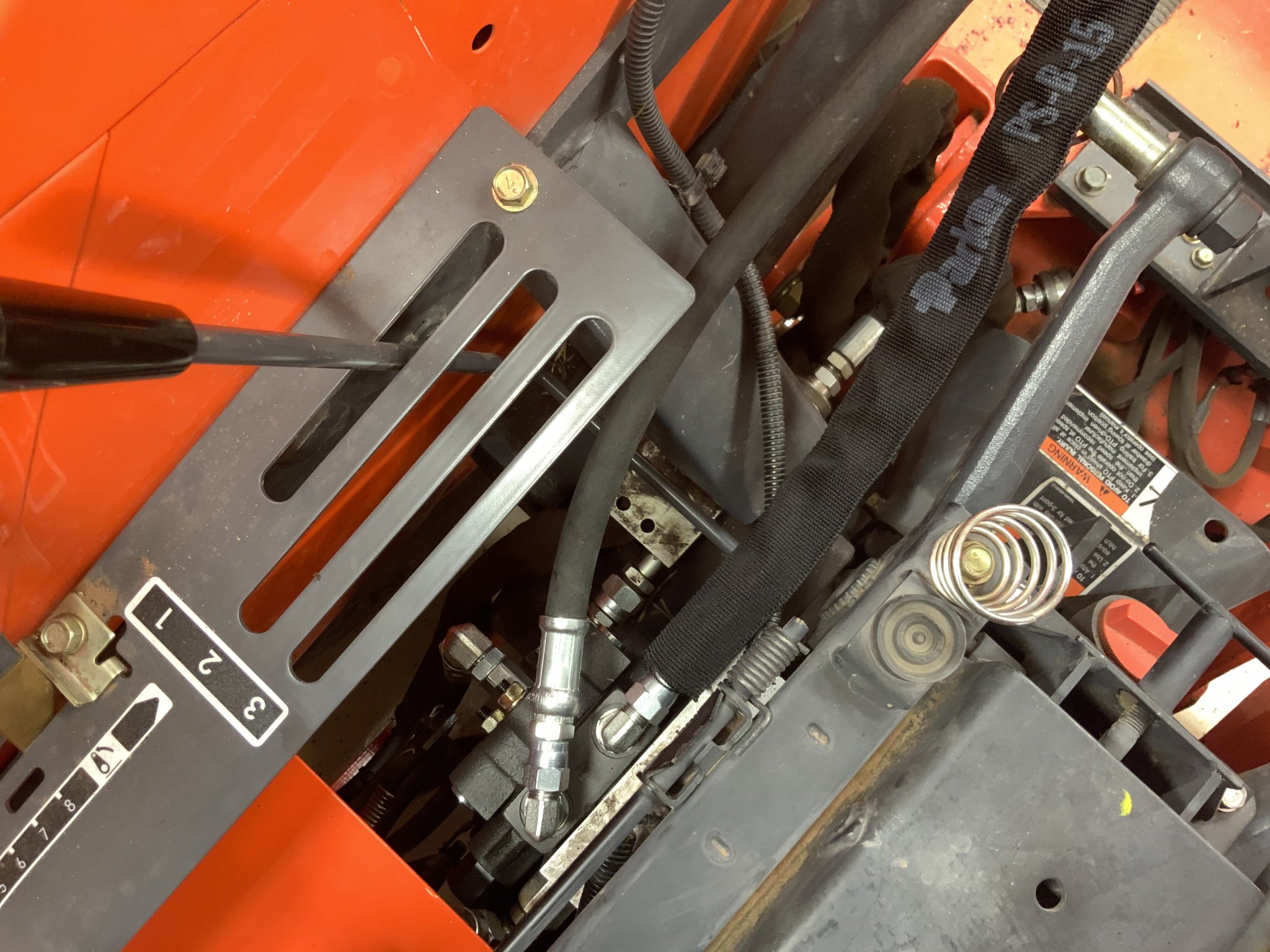

Thanks. I see you're using one of your rear remotes to control it.
I actually had it that way in the photos originally and changed it to this a year or so ago…no real function difference, just easier to reach.
