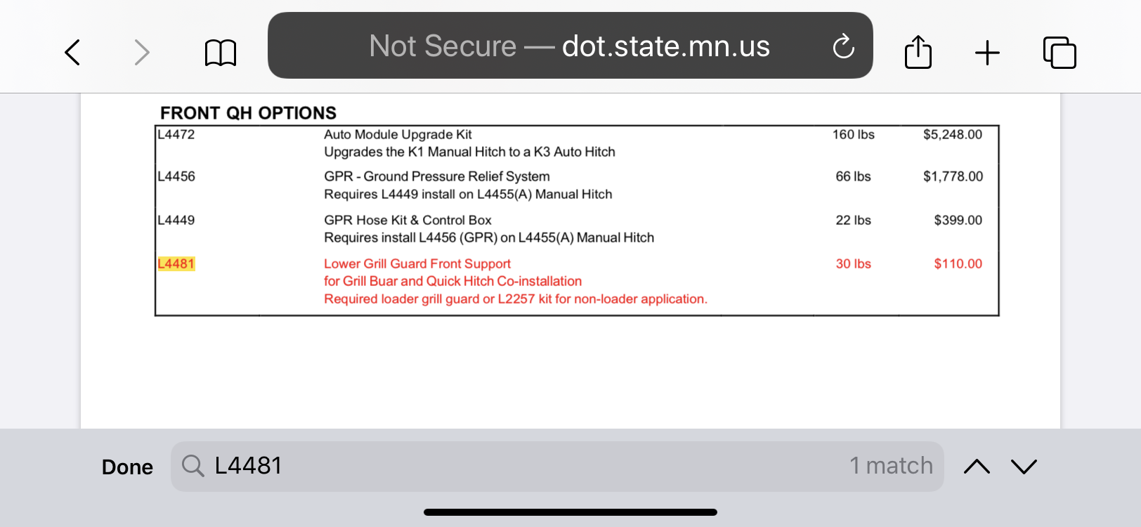

I'm pretty sure the part you want is L4481. Cost ~$100.
This was the only thing I can find with that number.
Got a reply from Nate at Messicks, “That L4481 kit below won’t work for you. It’s for the Grand L60 series and the new 4 point auto hitch system Kubota has.”
