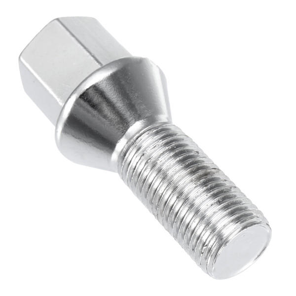

I have failed to understand how this would work, unless the threaded portion of the new wheel studs are smaller in diameter than the original studs, or if the original studs had a larger diameter than their threaded parts. (hole in wheel flange larger than threaded stud diameter)
Can you explain further what the studs looked like, and if the nuts/studs holding the spacers to the wheel flange are the same size as the originals?

I will try, the factory studs are threaded into the axle housing and the wheel then is installed onto the axle and is hub centric on the axle, the new spacer requires removal of studs as I mentioned. The spacer is then installed (not hub centric) using provided tapered bolts that center the spacer to the axle. The spacer has preinstalled studs that hold the wheel to the spacer with the factory nuts and washers. The spacer has 6 holes for the tapered bolts to axle and six studs for the wheel.
