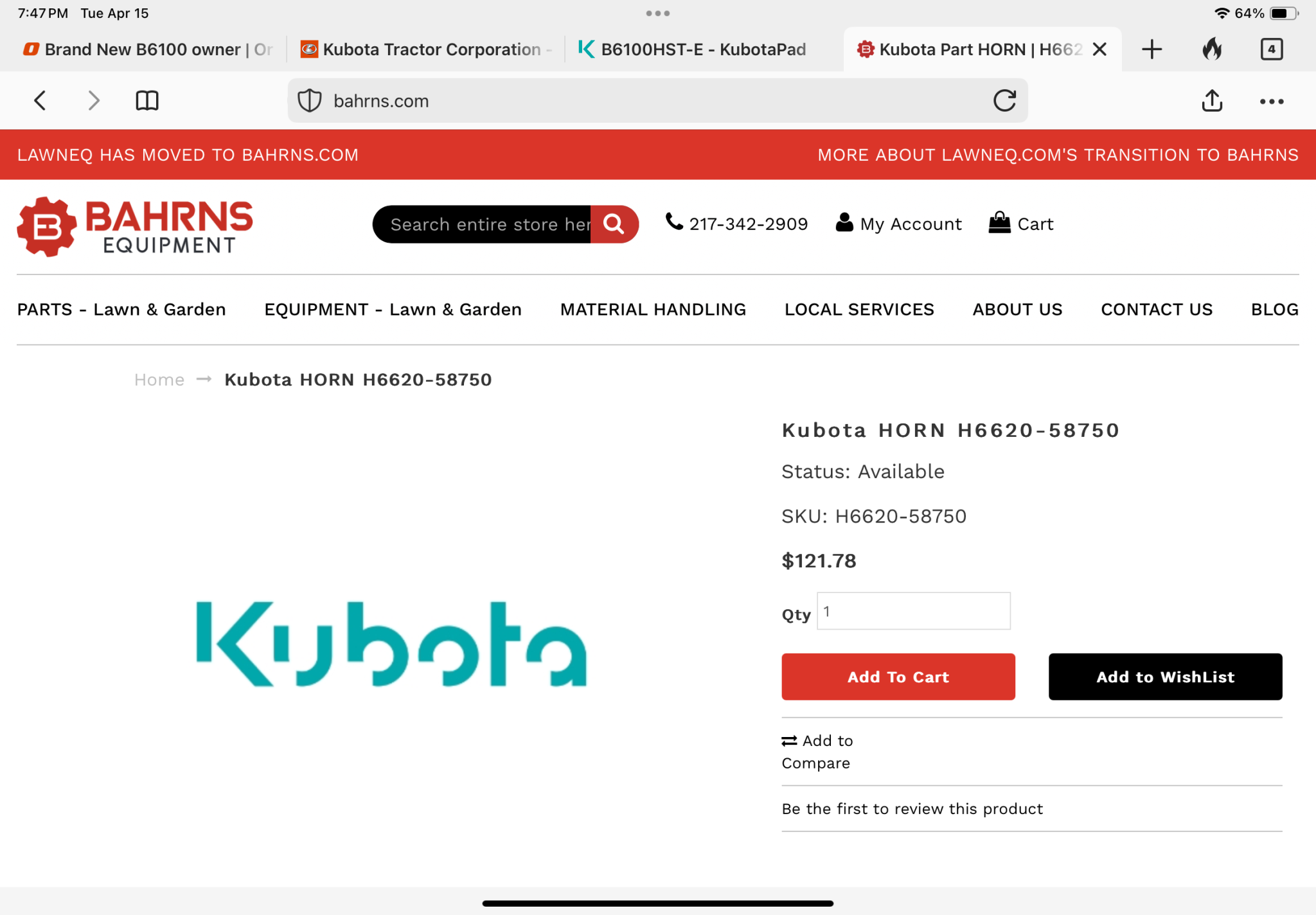

If you need the whistle Here is one source but they may not really have any.
You can contact @Mountainman to see if he has a used one
