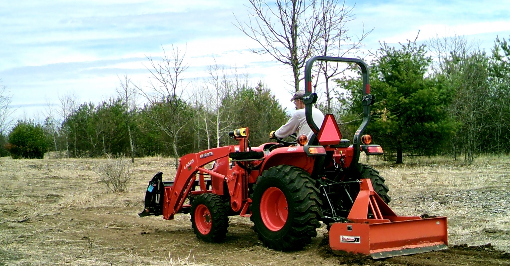

I would think that the 60 inch would be a better choice, but with that being said, nothing would prevent you from running a narrower one especially if leaving tire tracks behind in your project is not a concern.
I ran a 48inch KingKutter XB box blade behind my L2501 all last summer. Not my first choice for the tractor but I already had the 48" for my B7100. The work I was doing with it went just fine even with the rear tires outside the box. The XB is a light duty box and I knew enough to not get it in situations where I might tear it up.
