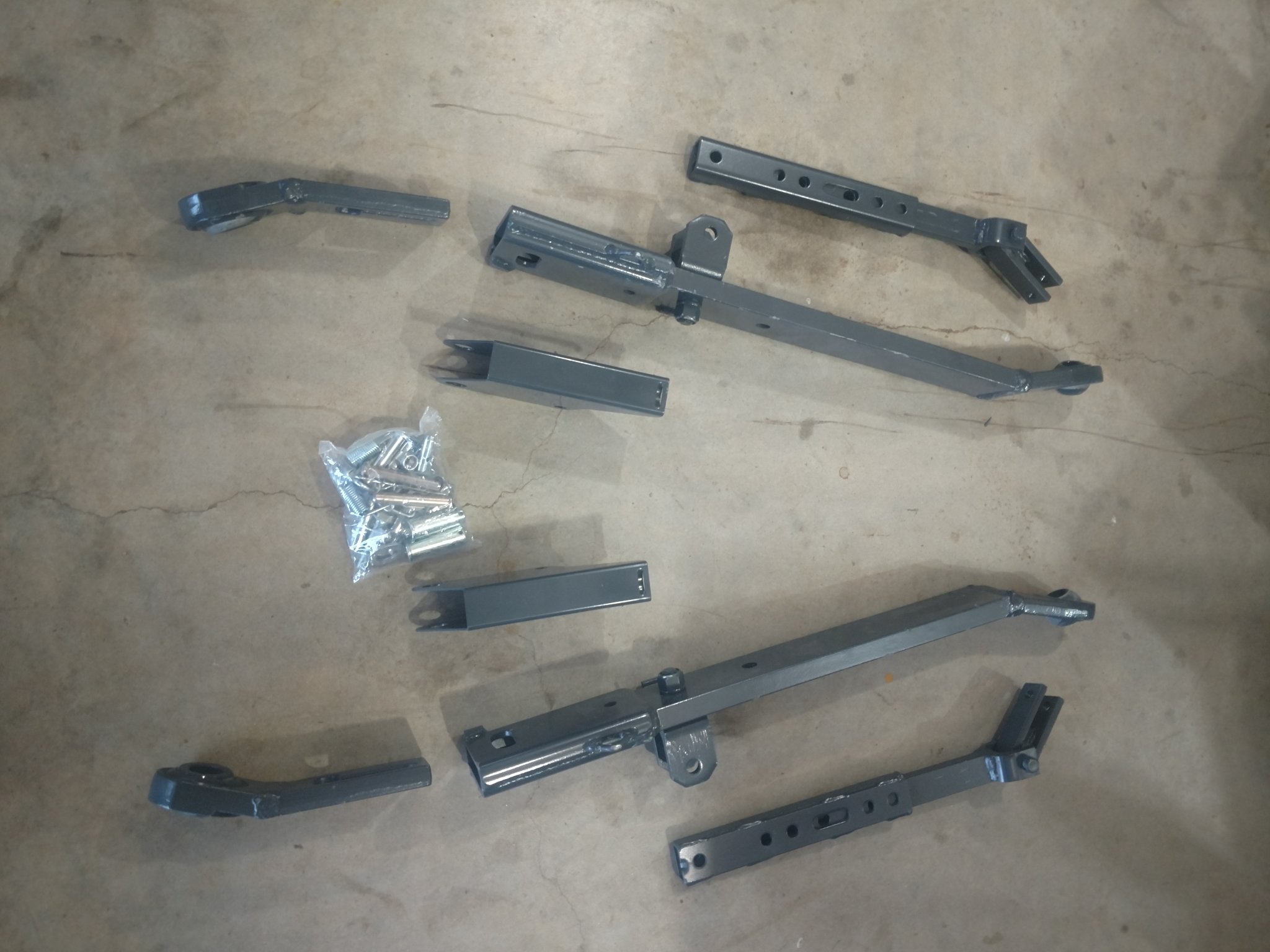

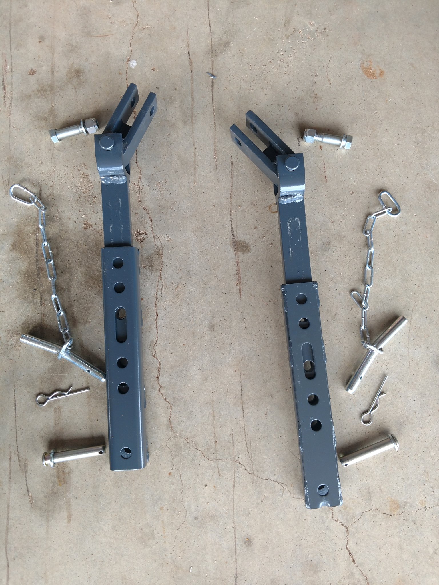

Anyone curious what “kit” I used to convert my standard lift arms to telescoping… I used the “kit’ for MX9495 lower arms. It was an easy swap-out. (I did not need the telescoping stabilizers…and still have them N.O.S. if anyone needs such to get rid of turnbuckle or non-adjustable stabilizers.)
Here’s a pic (lower pic) of the entire “kit” ….and the top pic is of the stabilizers I’m still offering in the classified https://www.orangetractortalks.com/forums/threads/new-telescoping-stabilizers-for-sale-cheap.67447/ IMG_4622.jpeg
