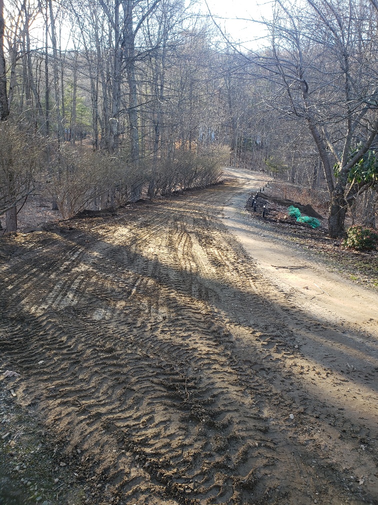

I've used my box blade to regrade the driveway a few times. This spring I wanted to regrade the lower section that looked like this to start:

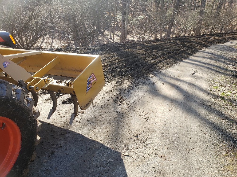

First I ripped it with the box blade using the top n tilt to angle the dig slightly and pull the box forward so the scarifers really dug in.

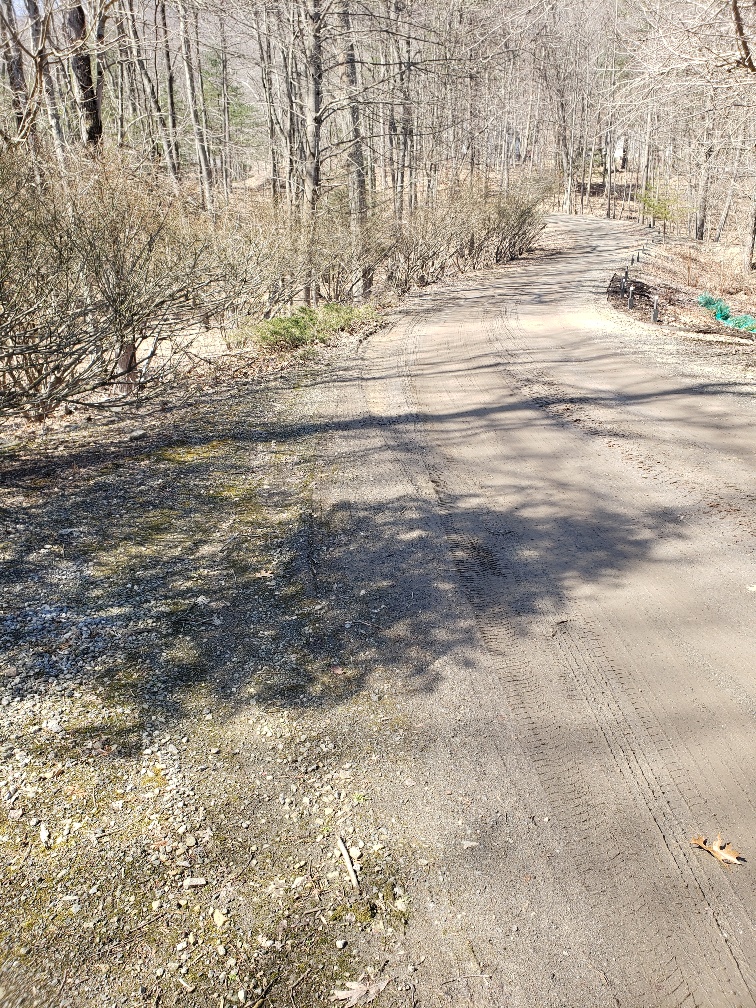

The top link was then extended all the way so when it was lowered and dragged the blade on the back smoothed out the spoils. I also used my back blade in the end to make sure I had a pitch to the side.
You really need some process material (I use 3/4") on top to finish everything. I still need to bring in a triaxle to trim the whole driveway with. It packs down well just driving over it if its damp.
It isn't so hard, after all I can do it. Just takes some practice - you won't break anything!
